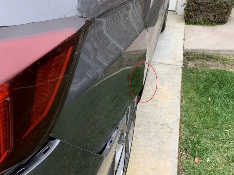

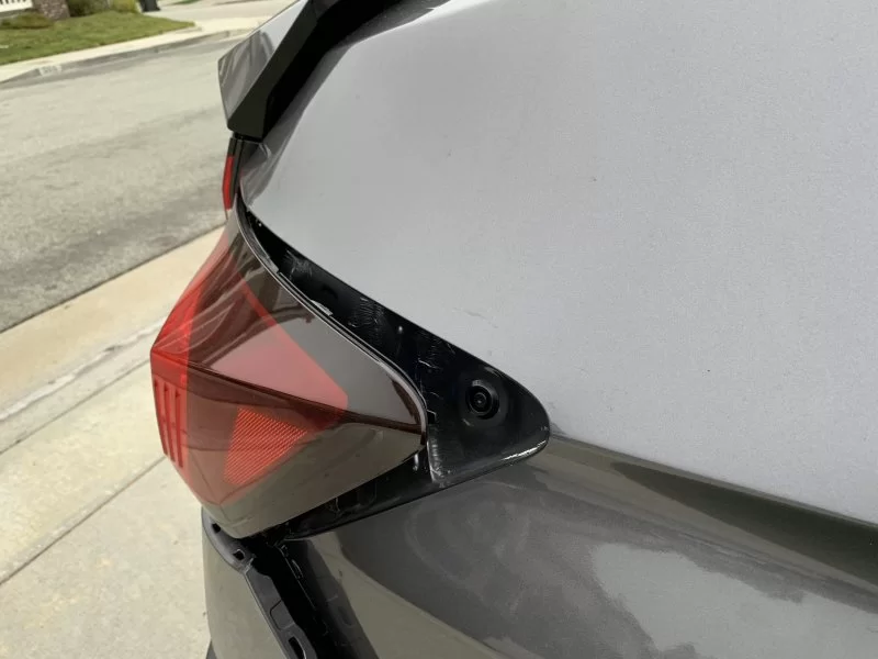

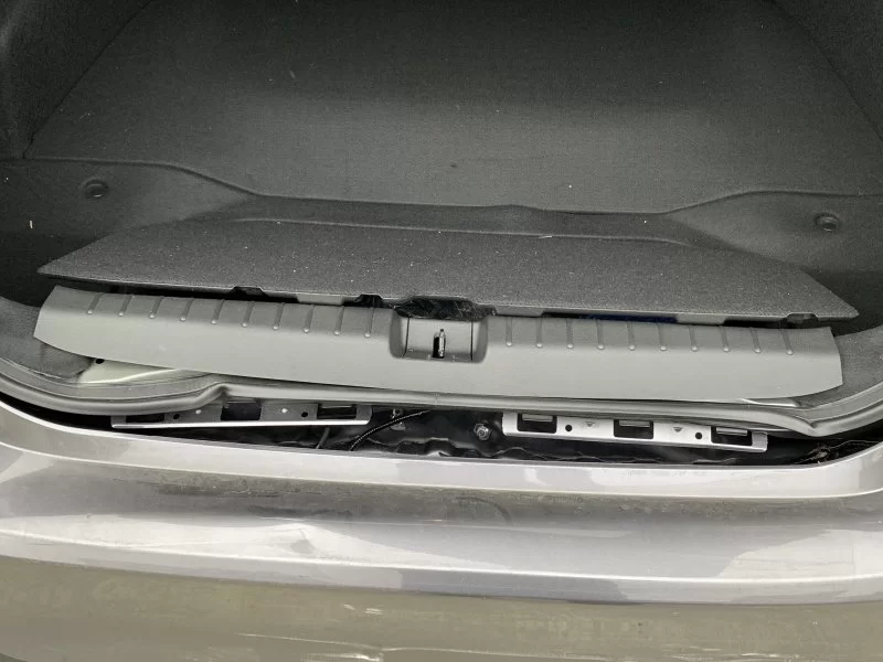

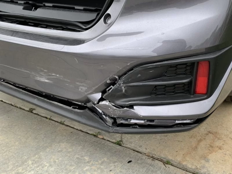

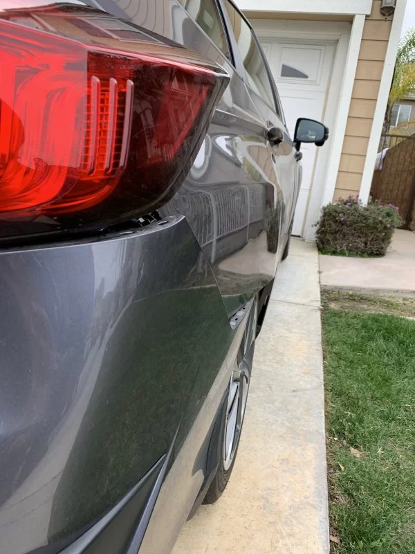

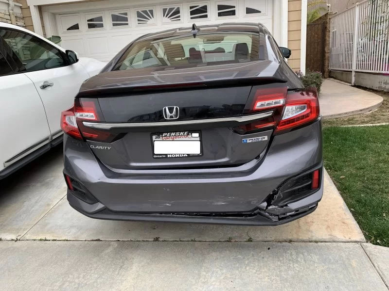

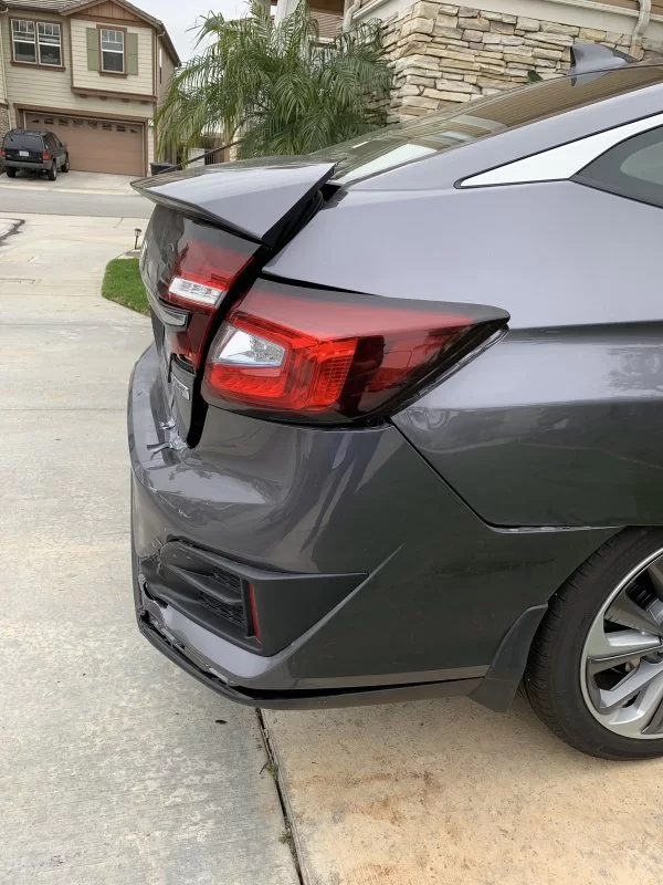

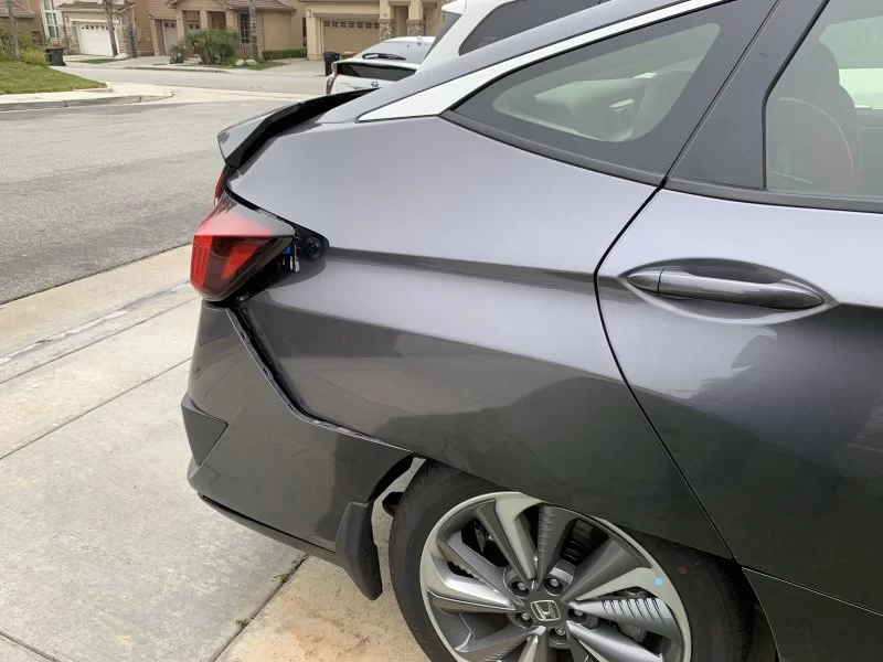

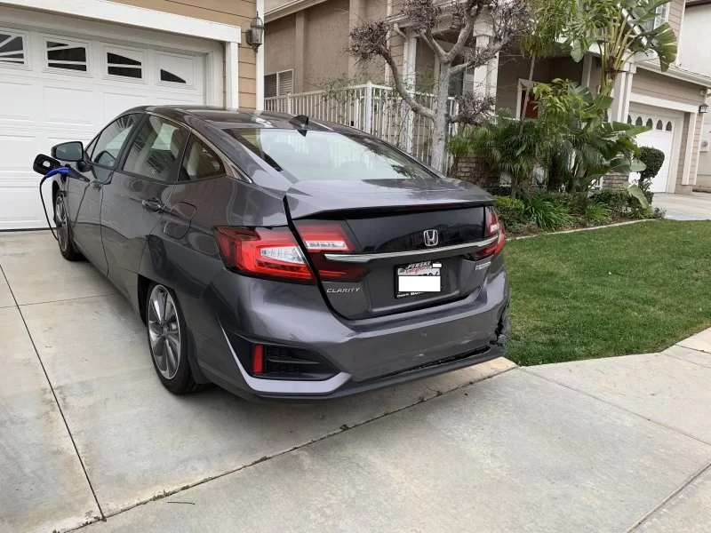

I just got rear ended last night on my 2 month old Clarity. :(
Wondering if anyone know if this look serious or not... the right side (see picture with Red cycle) seem to have bent/warp a bit.

Make sure the body shop is one that can work with aluminum and follow the temperature and time limits baking in the paint booth or your battery will be damage. A shop that is certified for Teslas would have the knowledge and skills to deal with both aluminum and the temperature limits on the traction batteries.
