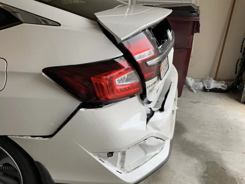

Well I am sad. I was rear ended at a red light by a Chevy Tahoe. A young teen was driving and hit me going around 20 mph. Needless to say they are at fault.
The damage was pretty bad as you can see but inside the passenger capartment all was fine. Everyone was okay.
Just wish it wasn’t my 6 month old Clarity. I love this car and babied it. Part of me is afraid on how they will fix it and if they will do a good job. Another part of me just wishes it was totaled and I can start anew. Underneath the bumper the metal is all twisted upward. I’m not sure if this is the frame.

View attachment 3852 View attachment 3851 Well I am sad. I was rear ended at a red light by a Chevy Tahoe. A young teen was driving and hit me going around 20 mph. Needless to say they are at fault.
Has anyone been in an accident like this?

I’ll hazard a guess with the minimal photos provided, that final repair will cost between $8k and $12k, and it’ll take the shop about a month. Assuming they can get the parts. Just based on my previous 25 year career appraising wrecked cars for insurance companies and working with body shops. Sorry it happened...

Looks like the unibody chassis is damaged which means cutting out panels and welding back.

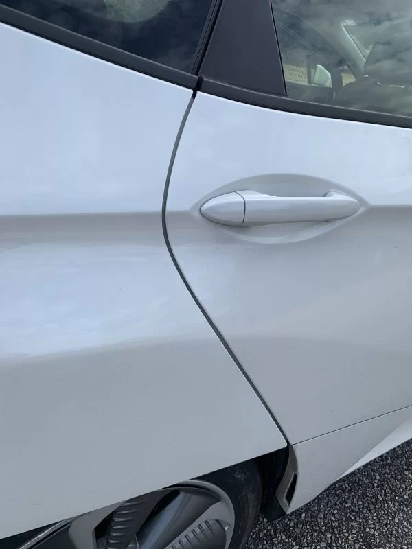

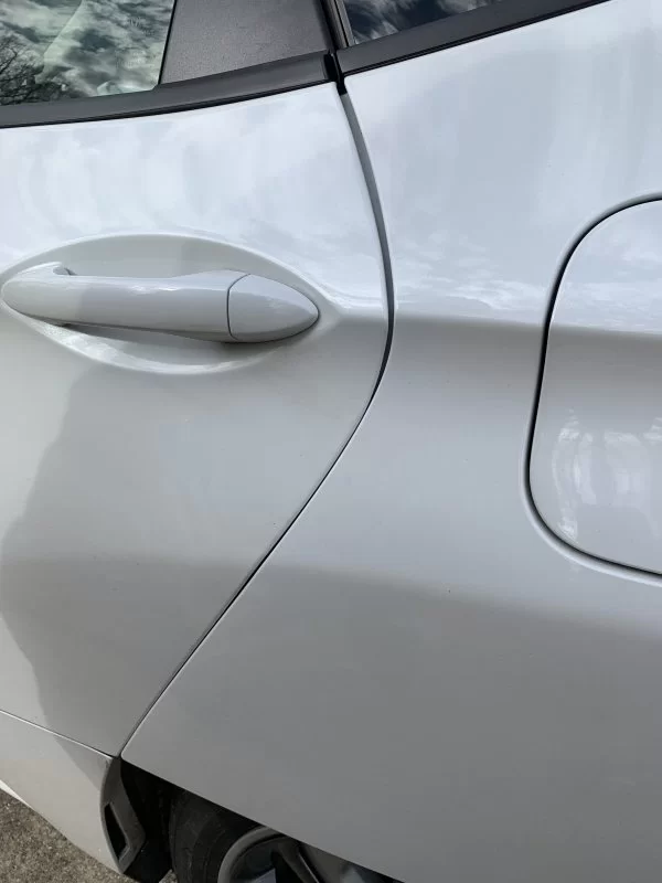

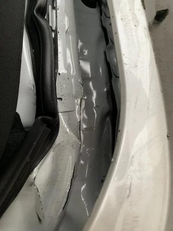

Here are more photos. Thanks for your advice. The car seems slightly shifted. The seams are gaping and narrowing on each side of the car by the passenger doors. I wish they’d total it.
Oh yikes. Get ready for an expensive quote, that’s probably structure damage. If you’re lucky, they’ll total it. But I hope they offer you something close to replacement value. When they totaled my LEAF, they only wanted to cut me a check for 18k, even though the car was only one year old! After much back and forth I was able to get closer to 22k for it.... but I still felt screwed.

LR door jamb being closed up like that means definite structural damage (as did the crushed rear body panel in the first photos), but that doesn't mean it's totaled in and of itself. Qualified shop can fix all that no problem. But still maybe totaled depending on price. Total loss is a financial calculation period. Insurance company compares the cost of repairs, with the cost of buying the car and getting money back by selling the salvage. So for example if they decide the car is worth $29K, and salvage value as-is is about $10K, they will total the car ONLY if cost of repair is predicted to exceed $19K. (Obviously I am making up all these numbers for illustration purposes only.)
