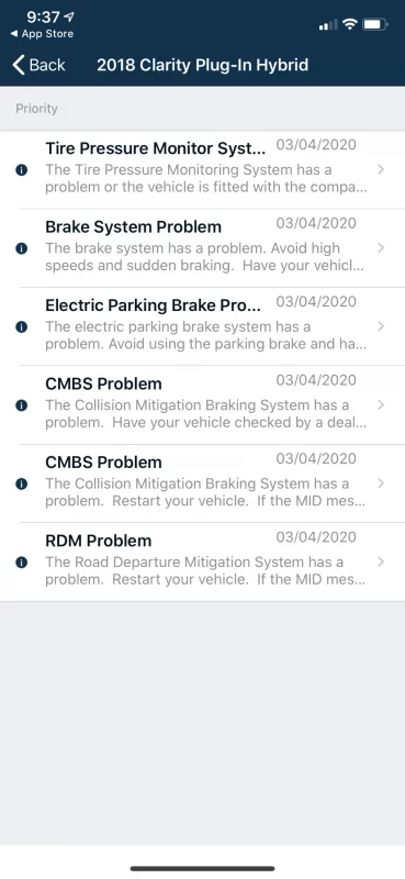

So driving yesterday I got like 6-7 warnings and my dashboard lit up like a Christmas tree.
after a few hours of driving, it went down to 3, then all went away.
but today they are all back. I read in another thread about disconnecting the battery but that didn’t work.
any ideas? Will the dealer charge me for this you think ? Car is 19 mo old with 98K miles.

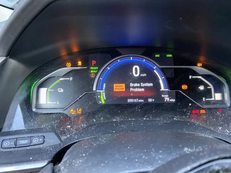

On the display under P | Ready | EV is the circled i indicator. Have you tried pressing the i button on the steering wheel and see what additional information the car gives you?
A low 12v battery caused this for me before. All went away once the traction battery was able to top off the 12v battery again.
Could be as simple as a quick battery load test at an auto parts store to determine if you have a weak battery.

Yes I’ve pressed I. It just cycles all these messages.
