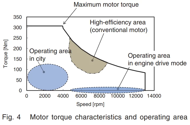

Just to complete the thought on Engine Drive mode, below is a chart from a Honda paper on the Accord PHEV which has the same kind of i-MMD system as the Clarity, and it demonstrates the very limited torque provided by the EV when in Engine Drive mode. All of us who ask for more power in Engine Drive mode knows that it immediately reverts to HV series mode.
