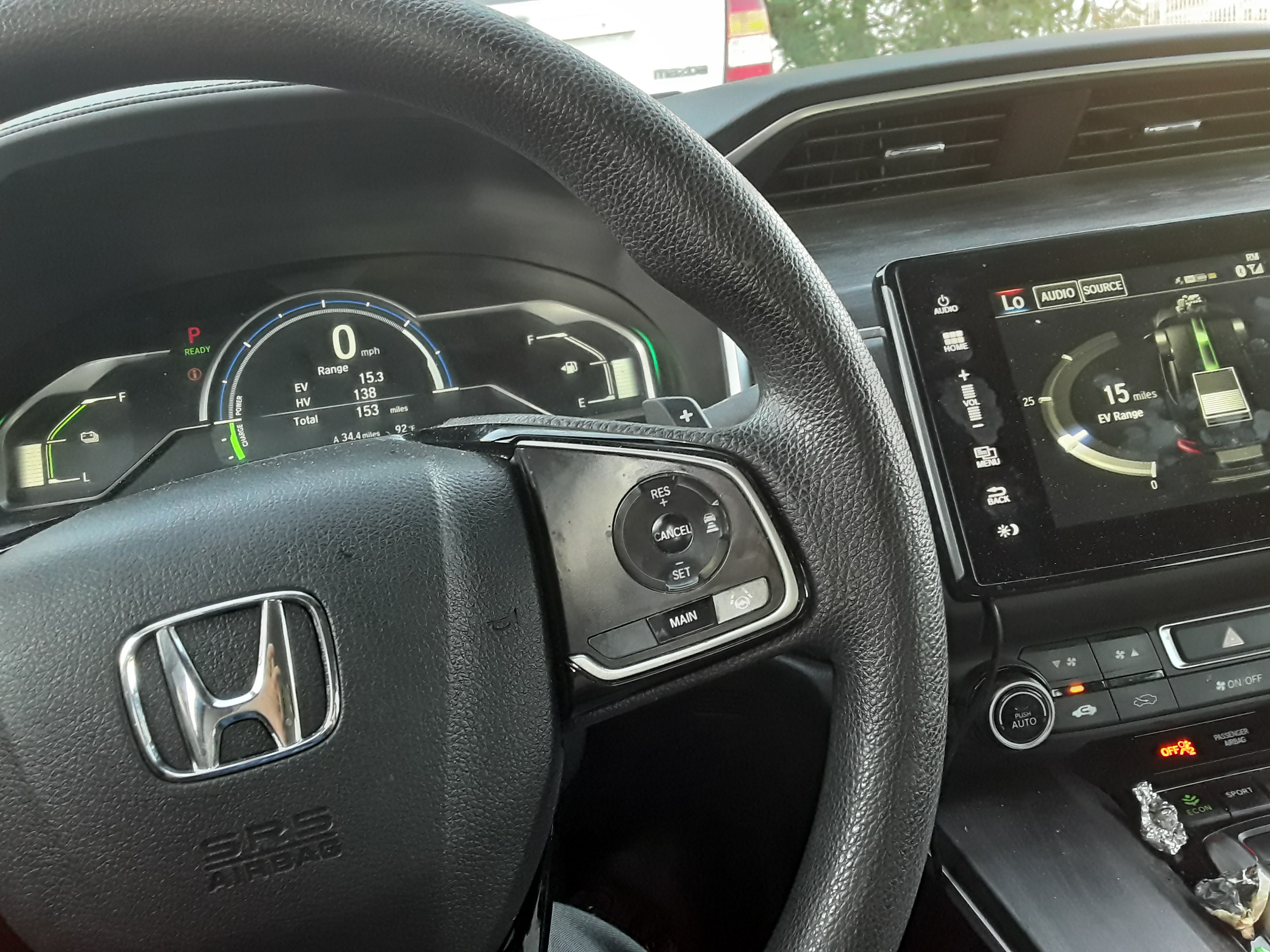

Today, I got in the car and turned it on. Before driving off the phone rang, so I sat in park to talk.
Within 3 minutes the motor cranked on. I attached a pic.
Any theories???

Check out the picture that I posted. It has all of your answers including showing it parked in the sun.
Sounds like it is not an engine maintenance start.
Does anyone know if the the engine runs when the battery gets too hot? To take the load off the battery. Mine seems to limit charging when it is parked in the sun.
Sorry, I missed that. I think I see what’s going on now.
Climate control set at maximum low temperature plus car in the sun = “The climate control system is in heavy use” which page 13 of the manual says is one of the 5 circumstances that may cause the engine to turn on or not turn off if already on.
So I’d call that normal behavior.

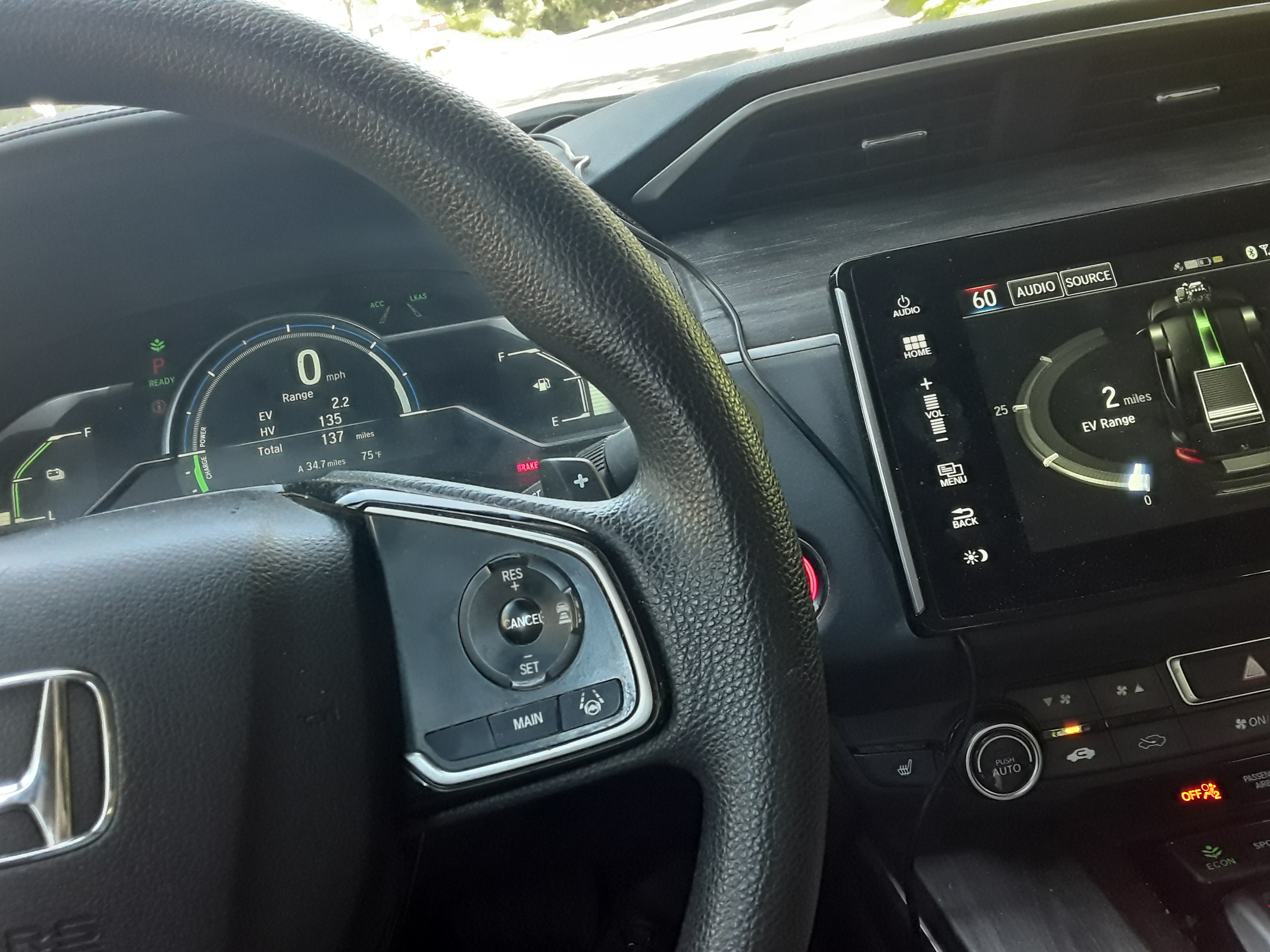

It happened again today, when the car was cold and it was only 75F outside. This causes me to now doubt the theory that the car is performing some sort of cooling operation.
I attached another pic.
Hello Guys,
I don't think I have ever turned on my car and seen 2.2 miles EV range. Or at least it's rare. If my car gets down to about 3 miles or less when I shut it off, the next time I turn it on it usually says 0 EV range and will be in HV mode (although ICE usually doesn't come right on like yours does). Not saying that has anything to do with your problem since I know you have seen the engine come on with higher EV range, but I'm just wondering if my car (or driving habits) are less common that my car always seems to set to 0 if my EV range is very low when I shut it off.

What is the "i" notification referring to?
Partial ditto. When I shut off with 2 EV miles left, our Clarity comes back on with 0 EV miles--but then the ICE starts up right away in my case.
When I shut the car off with anything less than 3-4 miles EV left, my Clarity comes back on with 0 EV miles but the blue line on the EV ranges is up to 12:00 and I can usually get to the free charger which is 3 miles away without using any gas. It seems like the EV range translates into some free electric juice even though the ICE was engaged.
Another ditto but with aggravation.
I was in the rare instance for me of just barely having enough charge to get home (and you know how I hate to run the ICE outside of the the seldom required but needed and appreciated System Checks). I’m watching the EV range and I had 3+ miles and 3 bars so I decided to go <1 mile and get some junk food. All was well until I turned off the car waiting for my order. When I turned it back on the EV range was 0 and the ICE comes on. Grrrrr!!!
I learned my lesson on that. Evidently, turning off the car causes some kind of internal reset on the algorithm or history or something when you’re close to the edge.
At least I’ve managed to go 12,000+ miles on 17 gal of gas so I’m not complaining. (Yeah, I don’t take many out of town trips)
