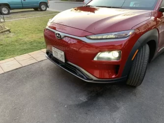

Hey EnerG,
I’ll attach a photo - not really a night shot - I took it at around 19:00 EST here. I’ll post some more later if I get a change.
There’s a slight loss of light. But it’s pretty much negligible between the halogens. They look far sleeker.
As per your other comment - I think it’s a non-issue these days. Most LED’s come with voltage regulators built in. It might be worth a shot! I’ve never actually looked at the car at night - any idea if the license plate lights are LED?

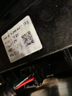

I had my wife put the car in drive while I poked around listening for the VESS speaker and I found it up top right in front of the radiator. I unplugged the module and did some driving to see if it affects anything besides the noise. So far, everything is still working great and the car is QUIET! The noise was fun for the first week but when sitting in Los Angeles traffic at 10 mph, it gets a little annoying. I'll post on here if I come across any issues. Here's a picture of the module.

I really don't want to sound snarky but disabling a pedestrian safety system seems questionable. Turning on the fan or radio seems a better solution.
