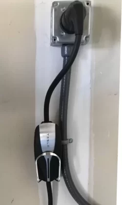

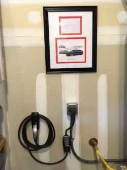

The included on board AC charger has a Max charge rate of 48 amps like the late model s.
The included mobile charge cable can be plugged into a 240VAC 14-50 socket but the cable itself is limited to 32 amps max (20mi/hr charge rate) (40 amp breakerX.80= 32 amps)
To take advantage of the higher 48 amp on board charge rate you will need to purchase the home wall mounted charger. ($500) from Tesla.
You will then need a supply circuit with a 60 amp breaker (60 amp X .80 = 48 amps max by code).
Don't waste money on a larger breaker because while the home charger can provide up to 80 amps to a model s with dual chargers the model 3 is limited to 48 amps max. (30 mi/hr charge rate). This is the fastest way to charge a model 3 at home. (really fast)!
Note that Tesla Superchargers charge a lot faster because they are DC to DC and bypass the onboard AC charger.
FYI: the onboard AC charger converts your home AC to DC internally to charge the DC battery.
Cautionary note: Don't make a habit of charging you battery totally full. This will reduce battery life and limit the ability to do regenerative braking. Tesla recommends that you use 90% as the charge limit. (310 mi range X .90= 279 miles)
Hope this helps............ Bill
