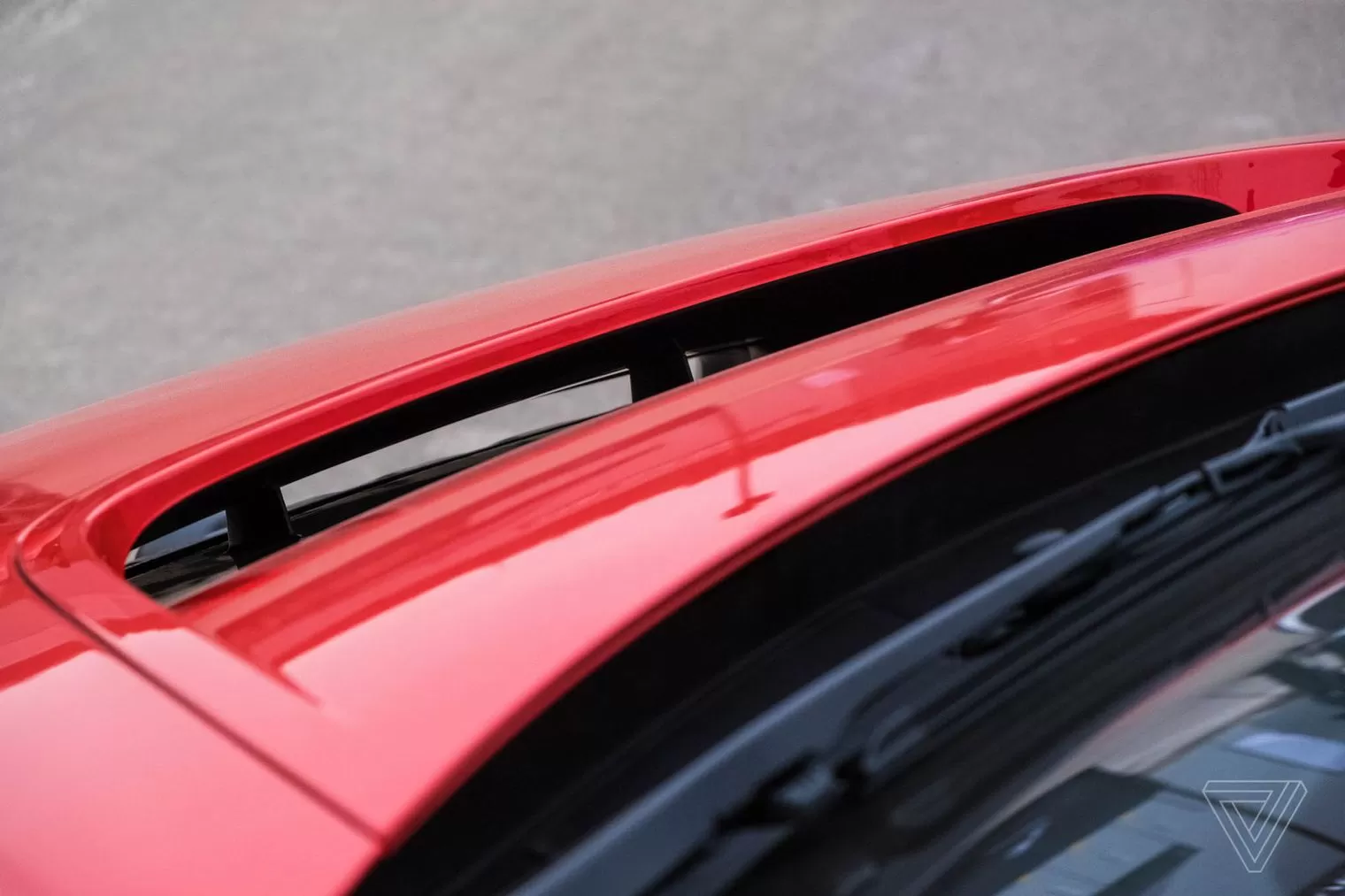

I recently became aware of the I-Pace hood air-vent:
The air inlet on the hood that takes air from behind the mock radiator grill and vents it out the top:
