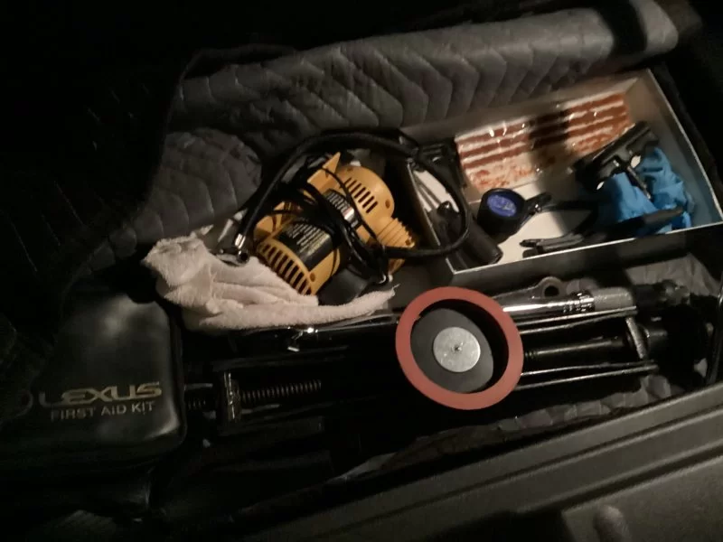

That’s what old guy carry in SE . You can plug any tire when a screw , nail is small , if any thing is large you should use a patch by professional as long tire is in good shape to patch .
View attachment 15761 That’s what old guy carry in SE . You can plug any tire when a screw , nail is small , if any thing is large you should use a patch by professional as long tire is in good shape to patch .
Compressor ,plug kit ,tork wrench .scissor jack from Toyota a gage to check a pressure.I do this on road in 10 minutes
