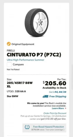

Pirelli and Goodyears also come on the SE with 17” wheels. Here is the Pirelli model available thru Tire Rack.
