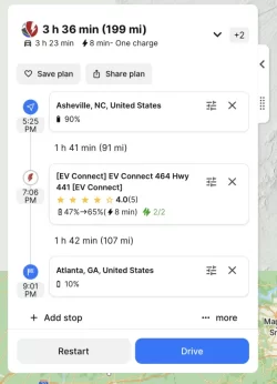

For example
One charge for 8 minutes to 65%, getting "home" with 10%? I'd charge to 80% minimum, it should only take an extra 10 minutes or so.
Based on the distances and consumption, that appears to be just an example, using an EV with a much larger battery.
Good point about being cautious on the first go-round, though. Once you have the car for a while you learn just how far you can push, but no need to do that at first (unless you absolutely have to).
I dunno, just plugged in the SE to get an example of what is available... didn't double check if it makes sense. The routine cross country adventurers seem to use two or three routing tools and compare. But ABRP always seems to be one of them.
Ah, I see what happened: by choosing "MINI Cooper 2024+ SE", you inadvertently selected the J01, which isn't actually available in the US. If it were, it would be a 2025 model year, just because of the weird way model years work here.
Interestingly, starting at 90% and using the reference consumption of 4.15 mi/kWh an F56-based SE could also theoretically make the same trip with only one stop at the same location. However, it would take another 24 minutes, charging at that point from 17% to 97%, and you'd arrive in Atlanta with only 5% instead of 10%.
