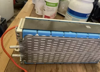

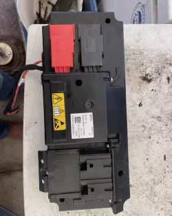

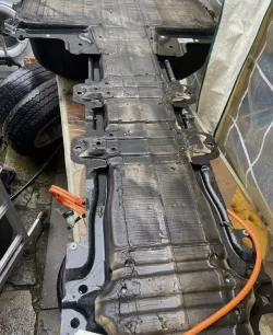

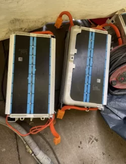

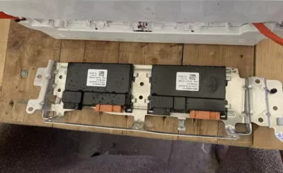

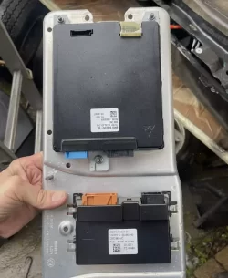

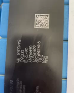

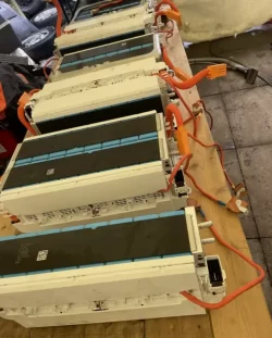

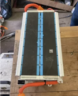

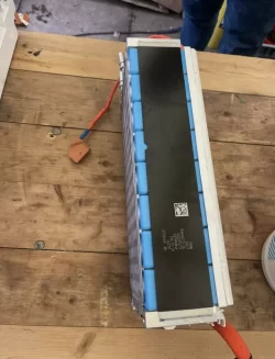

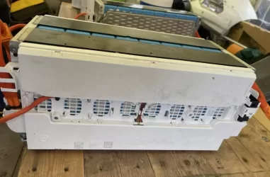

Hi folks,
i just found those pictures on ebay and thought you might be interested to look inside of the batteries and cooling system.

The problem is the small number of MINI Cooper SEs on the road compared to Teslas, Leafs, Bolts, etc. The SE's T-shaped battery pack isn't like most EVs' battery slab under the floor, so engineering a replacement would be more than simply adapting a common form factor for different slab-battery EVs.

What may well be possible, is loading up an empty Mini battery case with modules from another vehicle them making the BMS play ball. That may well help with the battery cooling, too.
I'd love to know the dimensions of those modules. I suspect about 4"x6"x12". A bit short compared to most modules.
