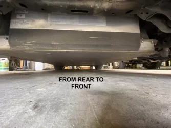

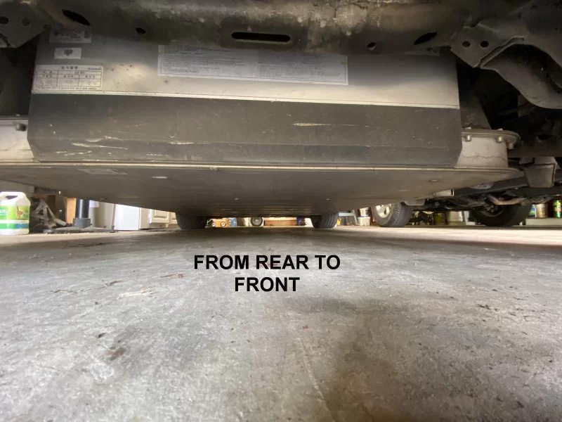

Our undercarriage is a long flat sheet metal cover. No appreciable wind resistance. We did test drive a model with no sheet metal. I could see the battery pack and the framework around it. I was thinking it was attached later but maybe not. There is no redesign of my 2019 that could make a significant difference.
A good question for the forum would who has that flat sheet metal and who doesn't.

The underside of our Kona EV is quite flat. Don't think any improvement would make a significant mileage improvement. We have the large battery. Maybe the smaller battery would be different.
How far does that rear plate stick out from the battery pack. Is your model a 2019 or 2020? I have a similar plate on mine(about 1 inch thick) attached to the pack (part of the pack itself) and held in place at the top by 4 huge bolts screwed to the frame, more or less a "protection plate" looks like to guard against damage to the tinny top part of the pack.
Sorry. no picture.
Just looked at mine and same as @GeorgeS. Only thing that might help is a taper tip fairing behind the square back battery pack, to reduce the turbulence drag. Think trailing edge of an airplane wing.
How far does that rear plate stick out from the battery pack. Is your model a 2019 or 2020? I have a similar plate on mine(about 1 inch thick) attached to the pack (part of the pack itself) and held in place at the top by 4 huge bolts screwed to the frame, more or less a "protection plate" looks like to guard against damage to the tinny top part of the pack. The distance was only 4-6 inches front and rear.
Sorry. no picture.
It looks like it may be the battery pack. It is a 2019. We did oddly test drive a different 2019 that had a lot more turbulence potential. It was not an ultimate like ours. Maybe it was the smaller battery.
