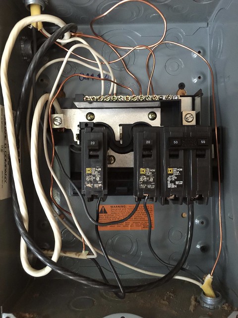

As a data point, when we added an attached garage to our N GA home, the contractor only ran one hot lead to it from the main panel, so such a situation is conceivable.
As a side note, I doubt he was either certified or qualified to do electrical work. When I later went to add a circuit, it became clear that the large, white neutral wire he ran ran to a bus that wasn’t hooked up to anything!
The right 50A breaker was tasked as a service disconnect. How did our outlets work at all? They were using the relatively small gauge ground as a return - a potentially hazardous situation. Plus, all the garage outlets were wired “backwards”, with the hot leads going to the wider slot on the receptacles. Since fixed, but wow!
