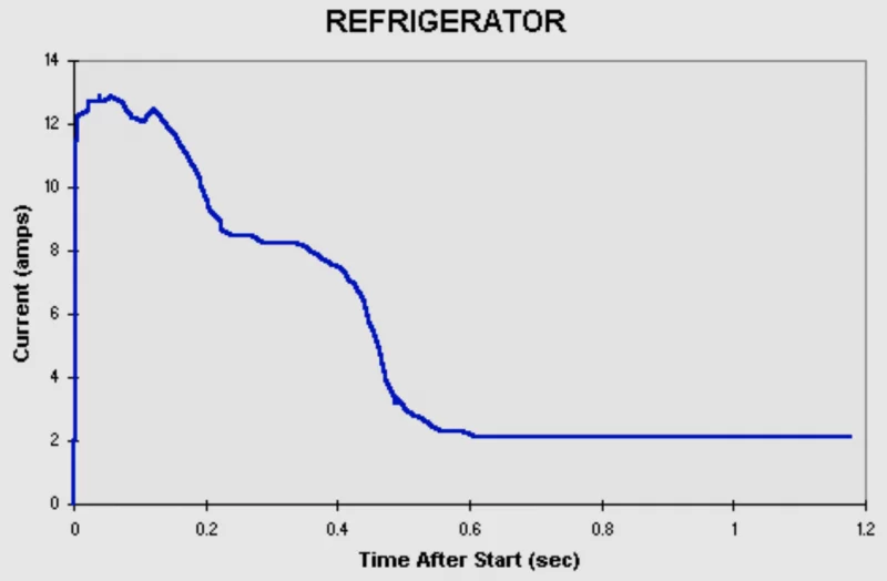

If the 15A circuit was not dedicated and had other devices plugged in it could indeed trip when charging.
A refrigerator compressor starting is a good example:
