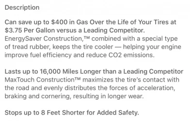

The replacement version of factory tire is warrantied for treadware for 65000 miles.
I will define that as life of the tire. Over the life of the tire Michelin claims you will save $400 of fuel cost at $3.75 per gallon. This would result in a savings of 106.7 ($400/$3.75) gallons of fuel over 65000 miles or .164 gallons per 100 miles. This would mean going from 44mpg down to 41mpg a 6.8% reduction. On the electric side your range would be estimated to drop from 47 miles to 43.8 miles. So, definitely detrimental, and definitely something I wouldn’t choose to do but it isn’t going to ruin the car.
