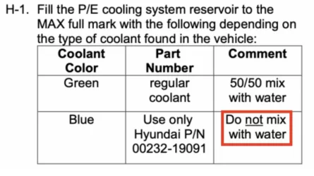

You are right- that would be a good deal "normally", however as @navguy12 mentions, there is a TSB. Here (credit @KiwiME ) you will find the copy.
This is presumably USA so a different # for Canada is involved. You will see the dates apply to Kona EVs equipped with the BSC-1 coolant manufactured from May 7th 2019 thru Oct 12th 2021:)

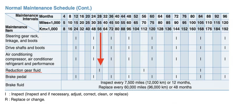

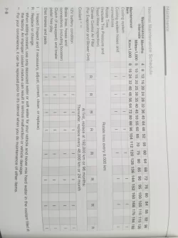

I checked a few owner's manual PDFs that I have and all are the same, much earlier than I thought it was.
Once the panel is off and the plug removed it seems silly not to just change it for the sake of the cost of a bottle of oil.
Huh. I've sold my '19 so I don't have my original schedule anymore. My memory was that the interval was something like 100k+. But I could easily be mistaken.
I’ve always thought it was 120,000 km but I’ve never looked closely. It might be that I’ve seen 120k as a replacement interval on some schedules. I take inspection to mean check the level only.

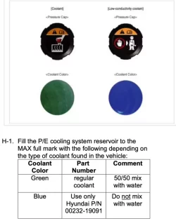

I had my blue coolant replaced under RECALL around 40,000km. Hence I should be OK for a while - 100,000km? The work did not take two days. But after a got my car back there was a 1/2 jug of coolant in the car with instructions to check coolant level and "top it up" as needed. By the time I got home from the dealer (~10km) the coolant level was well below Min. A topped it up repeatedly until the coolant jug was empty. The dealer gave me an other jug. 1/2 of it it still in my garage. Apparently it takes a while for the coolant to cover the whole system. Maybe that is were the two days come from. But unless the car is driven the coolant will not be circulated and settle. Supposedly there is a special vacuum pump to clear the old fluid out of the system. Maybe my dealer did not have it.
According to my service manual the reduction gear oil supposed to be OK till 120,000km. Inspected at 60,000km intervals. There is a loot of discussion on this forum how often this oil supposed to be changed. I am not going to take sides.
