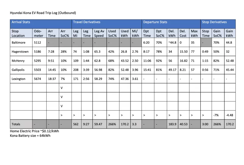

Hello! It sounds like you are in the right track. My only advise is stop and charge often- It will allow the chargers to charge at max rate and save you time, and I have discovered stopping frequently makes long drives much more enjoyable. I just got back from a 1000mi+ round trip, and am attaching the data for your consideration. Good Luck!

I realize this is not your first long drive, so much of this will be superfluous, but here is post from when I planned and executed my first long trip and while long it is full of useful advice from this forum that got me through unscathed: https://www.insideevsforum.com/community/threads/tips-for-first-long-drive.10413/
