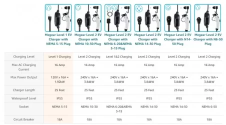

It seems to say it will try to draw 16A through a NEMA5-15 socket rated 15A. With a breaker tolerance of 7%, it might do it without tripping the circuit.
However, a NEMA5-15 can only deliver a continuous 12A safely.

I was tempted to get the Megear or Max Green level 1 EVSE on Amazon because it charges at a higher amp (and therefore faster). If you have a dedicated 20 amp outlet (or your mentioned 14-30 outlet), those EVSEs seem to be an attractive option. However, they actually haven't been properly certified and so there is a degree of safety concern when using these chargers.

Why use a Megear with a 14-30 outlet that will only throughput 16A when the circuit can safely carry 24A? Megear's 'one-size charger (16A) fits all' outlets mentality is definitely not the best idea I heard today :OP .
