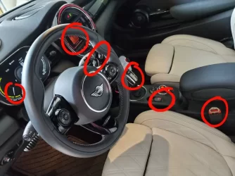

It is still very safe, as to make the car move the passenger would have to:
1. apply and hold the foot brake and simultaneously
2. depress the thumb switch and simultaneously
3. move the shift lever into gear and then
4. again, apply and hold the foot brake and simultaneously
4. deselect the parking brake
Here's a pic of the TIKIT installed, with the car in drive-ready, AC on, parking brake applied, gearshift in park, and the stereo playing, all with me standing outside the car with the door open.
VICTORY!
