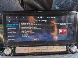

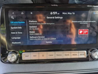

I tried to to that but it asks for a password, which I thought was odd. I attached my current SW and FW versions after navigation update. I hope everything looks up to date.
Now that does surprise me! I've never been asked for a password. These zips are normally not encrypted. Try just pressing return?
Lawrence
As someone else mentioned, there is no DAUDIO specific/separate update. That ZIP file, or even the extracted files won't install. They are already included in the NAV/SW update files. Yea, it's confusing, and frankly HYUNDAI should do a better job to make it more clear. The latest NAV/SW updates can take about an hour+ to fully install via USB. You just need to be patient.
