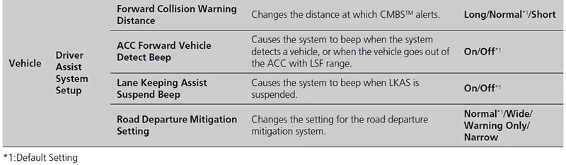

Since 2017, I've always gotten lane departure warnings (wiggling steering-wheel) when my Clarity's camera sees me going outside my lane (at over 25-30 mph) without using the turn signal. I don't know how to turn those warnings off. Maybe you're referring to the beep?
The Owner's Manual (p. 326) says you can turn the beep on or off:

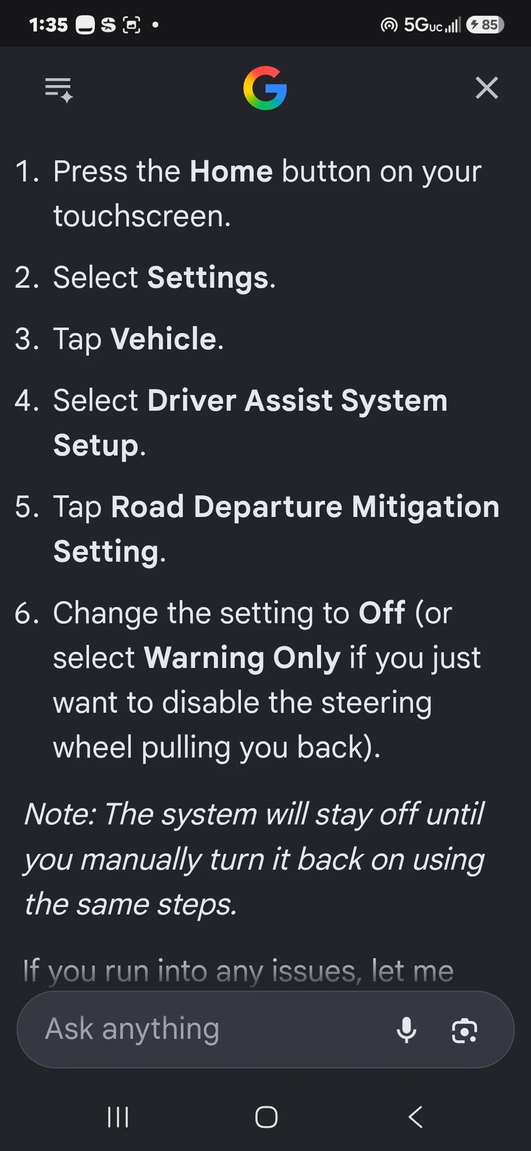

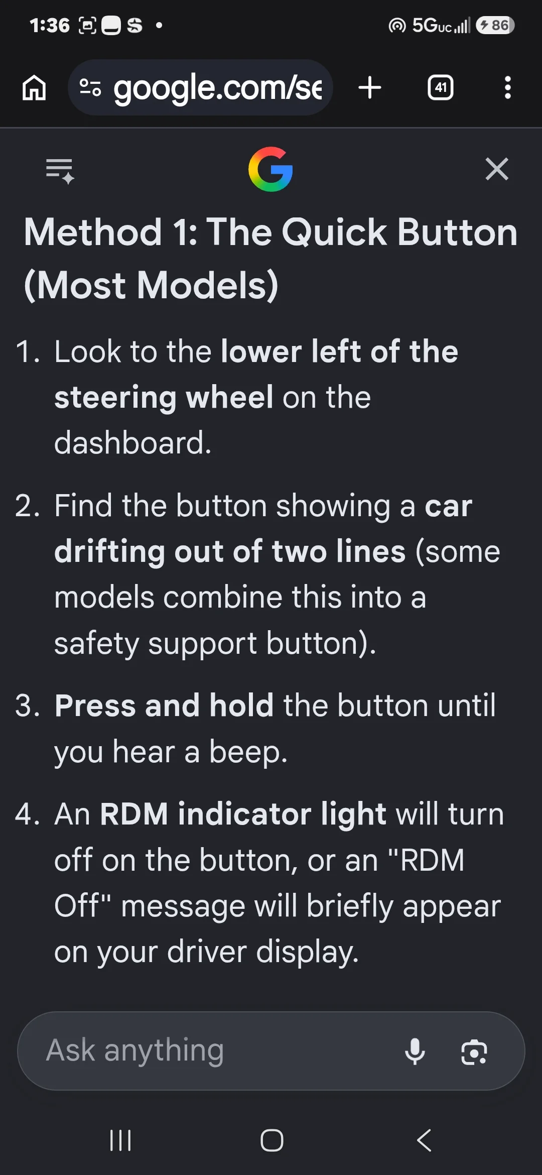

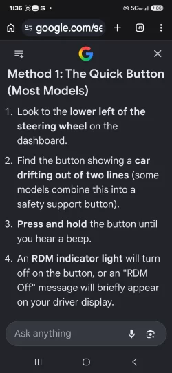

What about turning off LKAS
Hi Neil - that is what I have been trying to do - maybe I have mistaken something. I 'want' the cruise control which follows the car in front and don't want lane departure. If you have the magic info I'd be very happy :-)

Well thank you Neil - got it working (or rather 'turned off!) The second method didn't work as already had 'warning only' and NO option to turn 'off'.
The second one (Method 1) - worked but strangely.... never heard a beep but the long press got the two lines turned off.
So - thanks again!
