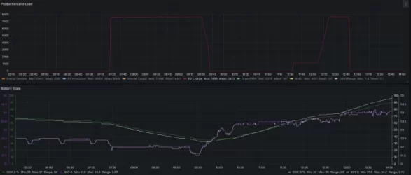

I'm actually doing this based on SOC... Today for example, I plugged in a car before leaving. Since the batteries were more charged up than needed I bled off excess into the EV until a little after 0940. Then around 11:30 my SOC caught up to the desired SOC, and I started the charge back up. By 1215 solar output had completely caught up, and charging ramped up full blast until it completed a little before 1300.
I have this on a sliding scale like 35% to 90% SOC weighted. The preference would be to have a steeper charge, ie wait until you actually hit 95% then funnel 15KW or more to the vehicle, allowing me to optimize for maximum SOC and not throw away any power. The steeper I can ramp up the charge the easier to guarantee close to 100% SOC when the sun goes down without throwing away any power.
