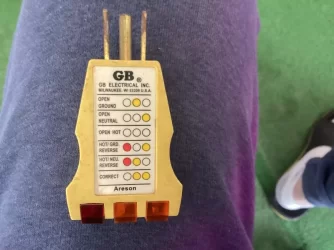

Go back to dealer like some members suggested and check an outlet power if is correct wiring try different outlet use a electronic cleaner on L1 plug maybe was never used and corroded

outlets. No lights, nothing. It's dead. I will see if I can have it repaired, in the meantime I need an affordable replacement,

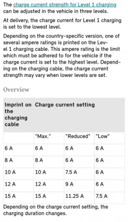

IIRC, doesn't the car have a max limit of 10 Amp for charging on L1? We got rid of the R50 for this, so I am really
enjoying driving both the R56, and the F56.
The charging current setup of my 2021 model for L1 charging has only "Max", "reduced" and "low", so I set it up as "Max". Depending on the current in/out of the supplied charger, the 3 levels will draw power differently. My charger is at 10A, so I set it up at Max. I understand that in North America, general household power supply is 120V at 15 amp. So it will be safe for a 10A draw. If you are buying a L1 charger for your home, for safety reason, do not buy anything that will draw more than 15 amp. Having said that, there are 15A chargers. In that case do not plug in more appliances in the same circuit while charging.
Per the manual the maximum L1 charge rate seems to be 15 A, but the L1 EVSEs (cables) usually are limited to 10 A since most outlets (NEMA 5-15) are on a 15-20 A circuit and EV charging needs to draw no more than 80% of circuit amperage.

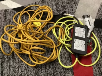

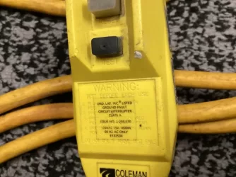

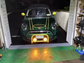

I’m plugging in 20amps outdoor GFCI Coleman fault circuit interrupter 50’ long which is rated 15 amp -1800 watts as factory charger come with my 2022 SE as L1 120 V. -1.2Kw./1200Watts .10amps .is working good for me without issues but my charging is mostly on L2 /240 V. In my garage .
