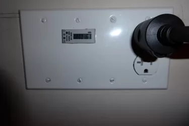

I just installed a KWh meter for charging my Clarity PHEV. The meter cost $58 plus shipping or $79.99 with free shipping from Amazon. I had to make a quick trip to pick up a part so once I completed the installation I plugged in my charger until it was complete. At that point the meter read 1.61 KWh and a couple of hours later it still read 1.61. The numbers on the meter are very small and I wish I had installed it at eye level so I didn't have to bend over to read it.
I make a lot of short trips and don't plan on having the engine start for months at a time. This meter gives me the chance to measure miles/KWh and then cost/mile.
I don't know how to get a picture you can click on, so I included the whole thing.
In case you can't read the small print on the meter, its an EKM-15E. It only works with 120 Volts but it supports up to 50 Amps.
I've looked in the past for a KWh meter that you can plug your 240v charger directly in to, but without success.

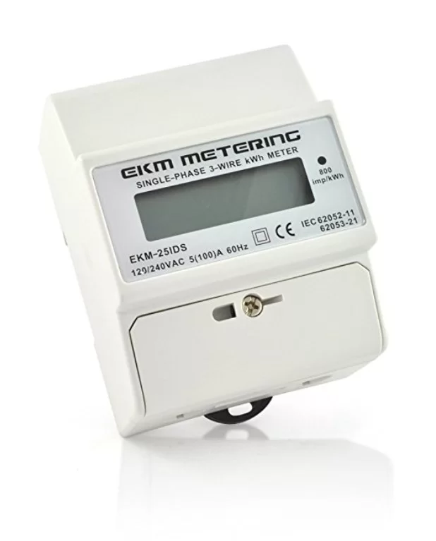

The same manufacturer also makes this one:
kWh meter.webp (Click for full size image)
It's $119 including shipping from Amazon.

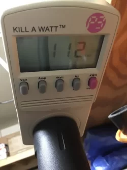

I have been using Kill-A-Watt to measure my charging. The device is rated at 15 amps and the charger draws about 12A. It never got hot during charging so I think that is fine.
It should be fine, I imagine any melt downs that have occurred were maybe damaged or had a manufacturing defect or something. I just bring it up as something to be aware of. Nice to see the car actually draws 12 A. I was always a bit annoyed when the 2013 and newer Volt's started defaulting to 8 A every charge.
My data is basically the same using the Kill A Watt. I show about 11.5 amps being drawn and get a full 110V charge in about 11.5 hours
