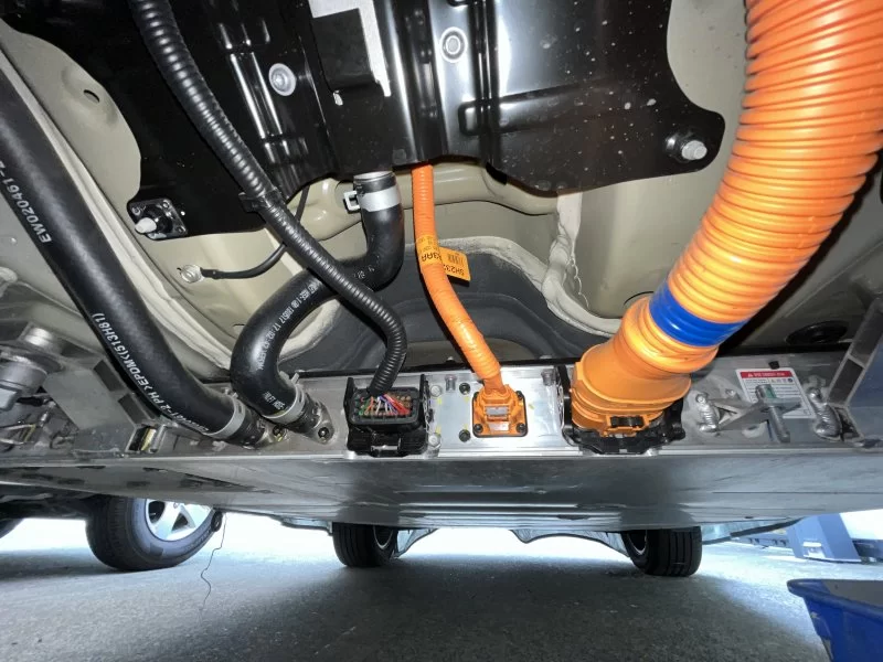

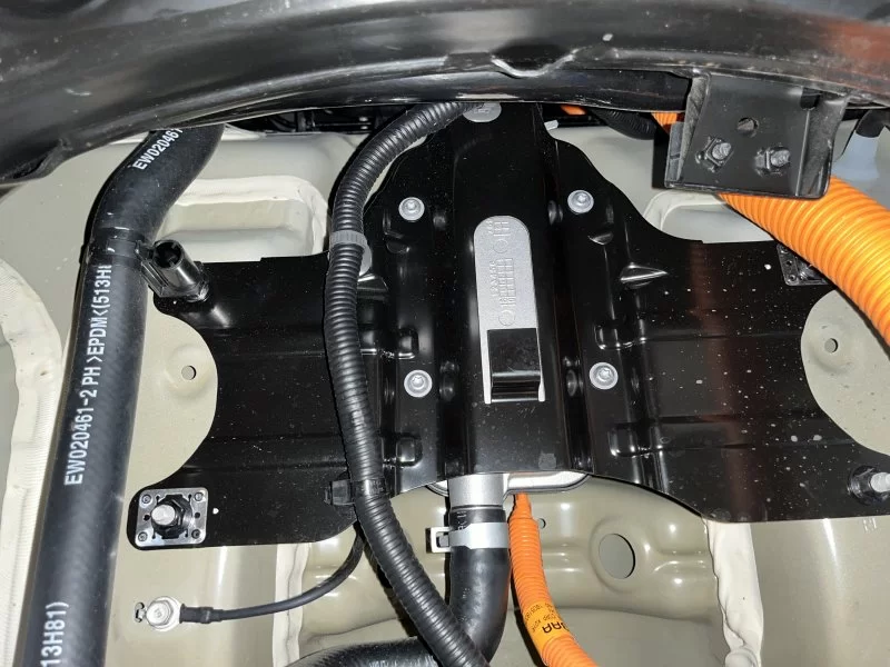

Winter is coming.. again! Has anyone considering modding their kona with "trigger battery heater" button? All the hardware to make it happen is already there, it is "simply" the matter of finding how to send the "plz turn battery heater on" message without interfering temperature safety thermostat.
Pix for the curious ...
