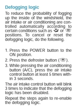

It was so humid this morning that the dash display was fogged up. Couldn't find anything in the manual about that one but running the car for 5 minutes with the heat pump only cleared up everything.

ICE vehicles are better at maintaining relatively dry environment because of the engine and exhaust heat that's drying up the air. Electric vehicles need extra kick from the AC to sustain the moist at the right levels. I'm not sure what's the issue that the AC is running?

AC has ridiculously low consumption. And turning it OFF should affect the range with only a few miles. Not worth being in a humid foggy environment for that. It was engineered this way for a reason.

I'm certain the HP-equipped Kona is perfectly capable of dehumidifying using cooling and reheat, just like on an ICE car and just like any building HVAC. It's not like a highwall type heat pump where it has to cycle between heating and cooling because it can't do both at the same time. Here are the two components that do this.
When the temperature and moisture level outside are greater than inside the car, moisture will condense on the exterior of the car glass. Similar to the situation when it’s colder outside than the inside of your car, the goal is to change the temperature on the inside of the car to match the outside temperature.
