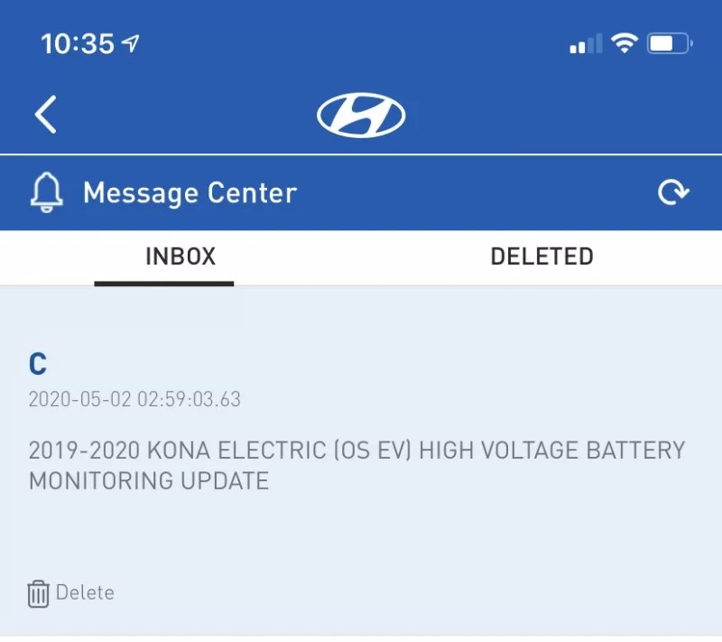

In regards to the BMS update how would I know if it’s been done to my car? I purchased mine in July but don’t know the manufacture date off the top of my head?
If you look in BlueLink, does it tell you that an update is needed?
From the main BL screen, you’ll see a message alert in the top right corner. If you click on it, you’ll see a message about a Hv battery service needed.
I don’t see an update listed anywhere. Would it be on the front page?

Thanks everybody. I have no alerts in BlueLink and no older messages. In regards to brake light function with paddle and the info in the users settings, I will check the next time I get to the car.
If the update has been done, the "aux battery saver +" item does not appear in the "User Settings-> Other features" dasboard menu
So I’m in my car at the moment and I can’t seem to find “User Settings”. Is it on the center display or the driver’s instrument cluster?
Just a follow up. I found user settings on the drivers dash as you wrote. Thought you meant dashboard menu was a sub menu in the other features section. Anyway, I do not see “aux battery saver +” listed. So that should mean the dealer did the software update that was available pre July.
Just an aside so I know I went to the correct menu, in my car under User Settings the next sub menu is simply listed as Other and not Other Features.
Anyway thanks so much for the info.
