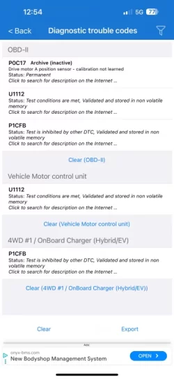

These are the codes that come up when I scan it with a Bluetooth dongle. Also it’s started to make a clunk sound when going into drive but only makes that clunk sound at the beginning. Sounds like gearbox issue but not sure if it’s both the gearbox and motor or just reduction box. Since I last posted Iv done 20k miles and drives fine apart from the noises Iv mentioned.
I am not sure what to replace, as online there’s mention of multiple things hopefully with that OBD reading it can narrow it down.
Any guidance is appreciated.
