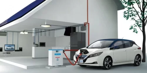

Nice setup.Why didn't you install a tankless water tank?Attaching it,and your [surge protected] breaker to a solar powered battery wall?
V2H is doable,and shouldn't mess the warranty since the kWh "load"is stationary, less stressful than driving.
System components: main charger / inverter unit, control switchboard, transformer unit, Wifi control pad.
Utility mode on the Kona EV is great,I know I can rely on it.Charge on solar to recharge if/when necessary.
