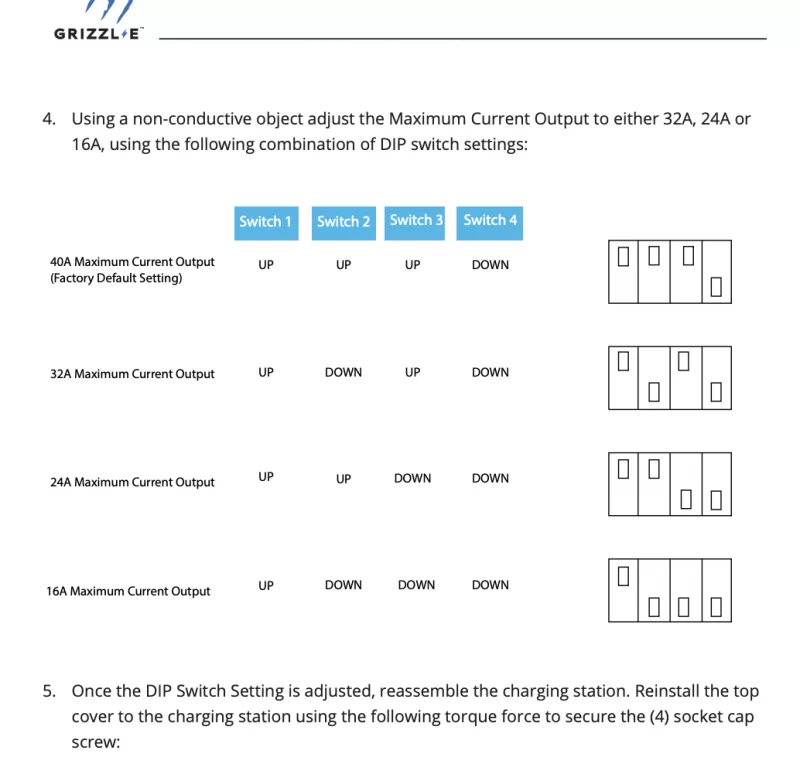

From what I read from the manual and web site, you need to adjust the dip switch to control the Amp/kwh output.
I set the dip switches on the charger to 40amp from the default of 50. But again, this is a dumb charger. It is basically a fancy outlet. It was doing this when I used the factory default of 50amp. It was never drawing that much.

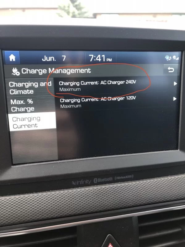

Check on the car, you should see something charging management /charging current. Select the 240V and make sure is maximum.

First, the car can be set to reduce the charge rate on AC. Go into the EV menu on your dash monitor and set your charge level of AC to max. This will allow it to use the full supply of the supplied charger.

Just want to add a picture of what others have mentioned. Check to make sure the settings for charge current are set to maximum in your car.

I did plug this into a charging station at it was able to charge at 7.4, just not at home. I also don't have a setting for charging at max on my car. I think it just is supposed to work.

I actually have the 4 dip switch version and it is set to 32amp. I wonder if the unit it bugged or something. I don't drive a huge amount but I will wait until it gets below 80%. I also followed the guide to calibrate the GFCI offset is, whatever that means.

Changed the image to suit. It seems that it may be faulty. Have you contacted the vendor?
You try working the DIP switches back and forth in case one is dodgy.
