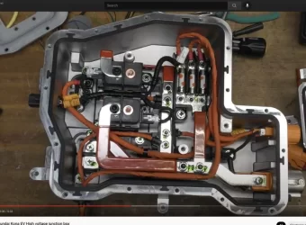

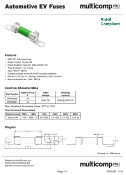

I posted on FB. You can almost certainly can buy the fuse from an electronics supplier as I found one years ago for the compressor as it was a weak item in the very earliest production. It’s a specialty item intended for EVs in particular.
It’s just a pain to replace it.
Obviously the PTC is inside the HVAC housing and even worse.
