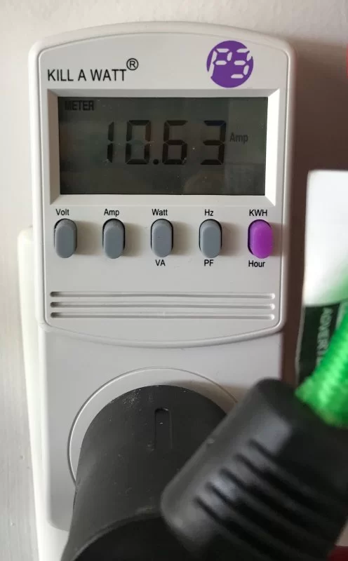

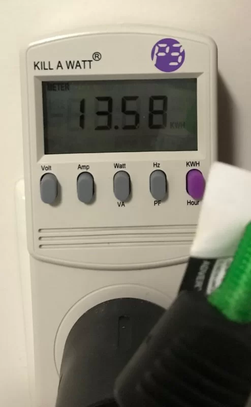

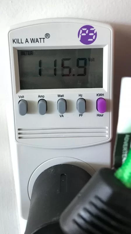

I am thinking of getting a meter for the 110V L1 home charger to tally the electricity usage for keeping the car topped off. Sounds like the KillaWatt unit is prone to overheating based on some of the reviews, but the other two seem to not have that concern. Any experience of suggestions?
1) KillaWatt: https://www.amazon.com/P3-International-P4460-Electricity-Monitor/dp/B000RGF29Q/
2) Poniie (has battery for retaining memory): https://www.amazon.com/Poniie-PN2000-Electricity-Electrical-Consumption/dp/B0777H8MS8/
3) Floureon (has volatile memory without battery): https://www.amazon.com/dp/B07B3VQBZH/

I've used a Killawatt in solar applications for years with no reliability issues. But, I wish I had a plug-in meter with a battery backup. I've lost a lot of data by accidentally loosening or unplugging the Killawatt while moving plugs around and if it's unplugged for even a fraction of second, all data is lost (at least on mine).
I have used a Kill-a-Watt inline with my 110v charger non-stop since February with no sign of overheating or other problems. Maybe I have been lucky!

I am very curious to see what numbers you come up with. Based on my analysis of my Pacific Gas & Electric Bill, I came up with about 80% efficiency using the Level 1 Charger, and about 92% efficiency using a Siemens 32 Amp Level 2 Charger. I do live in a hot location, and recharging has been in a garage that is around 85-90 degrees hot.
How did you calculate that? I have always heard that Level 2 is more efficient than Level 1, but have heard that the difference is small. A 12% difference is massive.
I’m as curious as @Mark W. Getting the kW going to the car’s onboard charger is easy peasy but how in the world are you accessing the amount of power exiting the car’s charger on the way to the battery. I assume these two figures are what are divided to yield the percent efficiency wirh the difference list to heat.
I’d really like to know how to do this.

I get a report of how much KwH it takes to fully recharge the Clarity. From my experiences it took about 12% more KwH to recharge with the Honda provided 120V EVSE, than it did with the Siemens 32 Amp 240V EVSE. If the 32Amp EVSE is 92% efficient, another 12% more KwH to recharge would make the 120V EVSE about 80% efficient. I think the reason for this inefficiency was that I was charging the car in a hot garage, and the Clarity had to turn on the cooling fans a lot longer while the car was charging.
