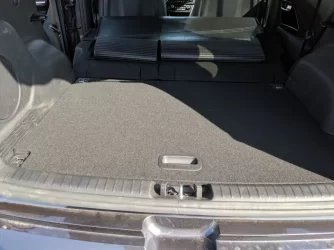

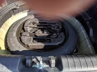

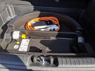

I have had a 2019 Kia Niro EV EX Premium for about 3 months. I probably don't have to tell you that I usually know more about the car than the dealership, or the salesman. Despite what these experts may tell you, the compact spare tire kit that fits in the standard Kia Niro Hybrid (NOT the PHEV) does fit in the EV. To install:
1. Remove cargo floor
2. Remove styrofoam insert and type 1 charger; save for reuse
3. Unscrew and remove styrofoam tire mobility kit insert; put inflator and goop container aside for reuse
4. Place compact spare and screw down with screw provided.
5. Place styrofoam tool kit holder inside spare.
6 Replace styrofoam insert from step 2. Type 1 charger, inflator and goop all fit nicely in this space.
7. Replace cargo floor.
If you are so inclined, the cargo mat with seat back protection from the Niro Hybrid also fits. What I have not been able to figure out is how to stow the cargo cover under the cargo floor like I could do with my Subaru Outback...
