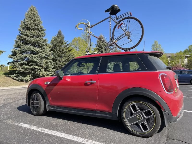

Would love to see a pic with the Mini brand rear flaps. If they look good I might add them if they help keep the back end cleaner.
I got the MINI mud flaps, the regular F56 ones just mounted right on. I was wrong in my memory of them, they work great to keep the front sides clean. And the backs work great too, but I still get dust on the rear window due to the nature of air flow on a hatch back design.
No noticeable change in range, so I'm super pleased. My life includes daily gravel road driving, so I need them. Here's a photo that shows both front and rear, I've been waiting for decent weather (and time!) to get better photos.
@Puppethead - Did you use the foam pieces on the rears, or leave them off?
I also installed front and rear MINI mud flaps and my findings are the same. The rears help reduce dirt buildup on the boot, but certainly don't eliminate it. (And they are far more effective with the stock 7" wheel & tire combo than my wider aftermarket wheels with meaty tires.)

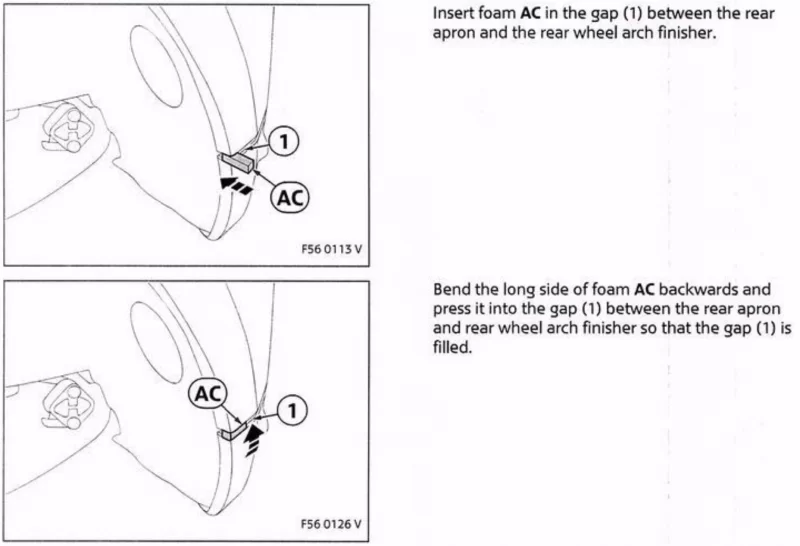

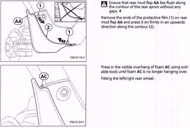

Dealer put them on when I had my summer wheels put on, so I don't know. Is there a way to check?
Probably easier to show images from the installation instructions than try to describe with words:
If you look in that area, does it look like there's foam in there? Or is it just the gap?
Looks like a gap, no foam that I can see. Although in the real world the foam might be hidden behind the actual flap, the fit is quite snug. The gap runs across the trim a shown in the last image, so maybe the foam is just used to block the front part of the gap (see second image) and is hard to see when the flap is mounted.
Thank you for reporting!
I believe the foam's purpose is to fill that small gap, likely to keep water from collecting behind the fender liner. The foam pieces included in the kit were much "deeper" than shown in the illustration, so they protruded much more. I have tried compressing them, but they eventually re-expand. If I were to do it over again, I would either trim them down or leave them off altogether.
