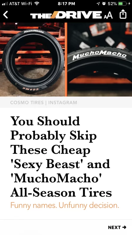

Just forget your “Blizzards”, “X-men ice sickles” and “hapakapottietooties”. Here is a real he-man tire:
(Apologies if this picture triggers any snowflake’s sense of cultural appropriation.)
(Sarcastic font enabled)
(Key Village Peoples Macho Man song)
No joke. The language police want Spanish speaking individuals to use the word Latinx rather than Latino.
Those tires, henceforth, shall be known as MuchxMachx

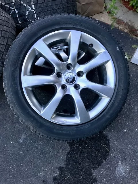

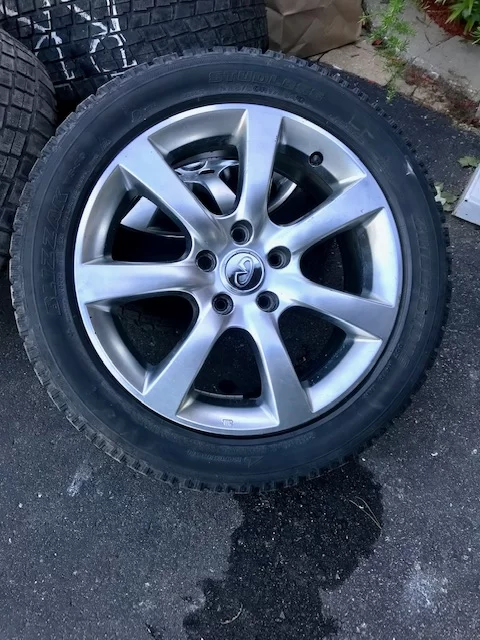

I purchased Blizzak WS-50's in 225/50/17 mounted on used infiniti OEM rims - very robust rims. The tires are very quiet and the ride is excellent. I have no issues recommending these tires in this size.
Nice wheels! I assume you’re using the proper hub ring spacers and the proper lug nuts, if needed.
