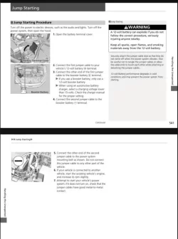

Since the manual only talks about jump starting a dead Clarity and not about using it to jump off another car, I’ll go out on a limb and start the discussion on what would be best practice for this.
Previous posts seem to indicate that the 12V battery is not kept charged up when the Clarity is not turned on. And, as stated, there is no alternator so the charge comes from the HV traction battery.
Based on these “facts”, then I think you would want to turn on the Clarity (EV Ready, not Acces, HV, or HV Charge) for the jump which would be analogous to running a gasmobile’s engine to keep the voltage up in the 12V battery. If you have a decent SOC in the traction battery, I don’t see any advantage in forcing the Clarity’s ICE to start.
Will the collective wisdom of the Clarity Brain Trust please weigh in, since I am not an expert on this and the manual is silent on it.
Also note that the manual is very specific on the placement of the cables and this may not just be for safety in avoiding a spark at the battery since it specifies an exact placement location for the neg cable on the power system mounting bolt and not just on any ground away from the battery. It doesn’t say, but this implies that it also might be for the protection of the Clarity. At the risk of losing my Man Card, it’s usually best to follow the instructions.

...Also note that the manual is very specific on the placement of the cables and this may not just be for safety in avoiding a spark at the battery since it specifies an exact placement location for the neg cable on the power system mounting bolt and not just on any ground away from the battery. It doesn’t say, but this implies that it also might be for the protection of the Clarity. At the risk of losing my Man Card, it’s usually best to follow the instructions....
Ken, were you able to buy a lithium jump starter that has cables long enough to actually reach that location? From the positive battery terminal to that mounting bolt is about 40 inches by my measurement. I haven't yet found a li-ion with cables that long. (Though maybe that's because I'm looking at the cheaper ones?)
Can anyone comment on whether other grounding points are clearly just a good? There's an attractive metal loop sticking up by the wiper fluid lid, just 11 inches from the positive battery terminal.
John:
Unfortunately, Ken has not appeared in this forum for over 2.5 years. We suspect something happened to him, but we are not certain.
I will offer my opinion - I think the precise grounding is totally irrelevant. The Clarity (unlike a conventional vehicle) does not have a starter, and hence there is no heavy load like a conventional vehicle. The manual does indeed specify a grounding point for jump starting. My feeling is that this is just to prevent a spark near the battery where there is a tiny chance of an accumulation of flammable gases. If you are outside and the hood is obviously open, this risk seems to be virtually non-existent.
I would not hesitate to connect a jump starter directly to both battery terminals. They are very accessible and convenient.
You could make or buy an extension for the negative cable on the jump pack. A 3’ wire with an alligator clip on one end and a male bullet connector, or something similar on the other end, would work.
FWIW: The instructions for the procedure are below. Note that with a dead 12V battery, it will not be possible to follow the guidance in the first two sentences.
Another FWIW: I connected a Genius GB40 Lithium Jump Pack directly to the + & - terminals on the battery just over 2 years ago, to start the Clarity after it has sat idle for 6 months and the 12V was dead. Still have the car and the same battery, both are working flawlessly. A4956B7C-75AE-4DF4-B938-F704D06DA37C.webp
