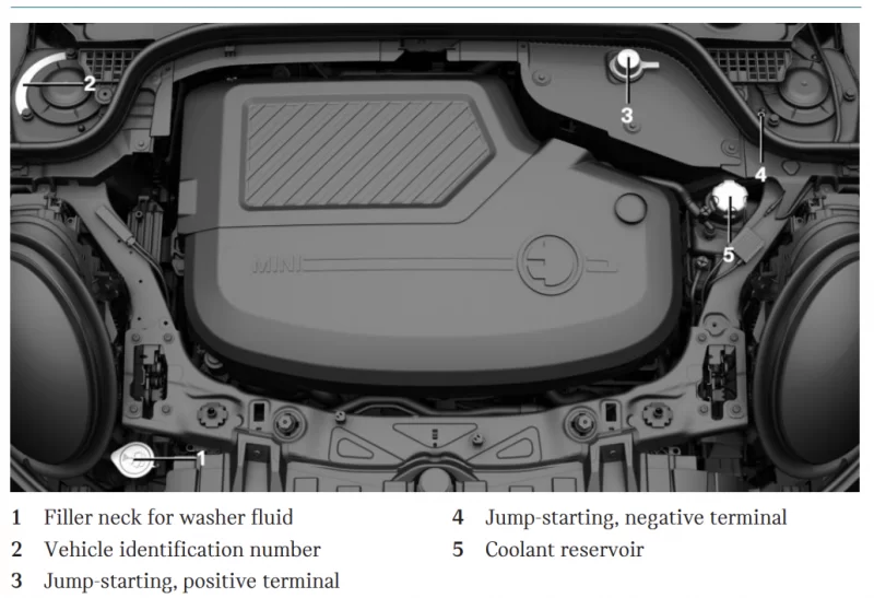

I jumped my wife's old Honda CRV last winter with zero problems. There is a big red cap to get to the positive battery terminal under the hood and right near it is the negative terminal on the strut tower.
Interesting that they are officially labeled as jump starting terminals. Any chance that is inadvertent carryover from the ICE version?
No, because as someone else mentioned, the SE still needs the 12V battery to power the electronics. If your 12V battery is dead, then you'd need a jump to switch the car on. Once that's done, the SE's internal charging mechanism would take over.
