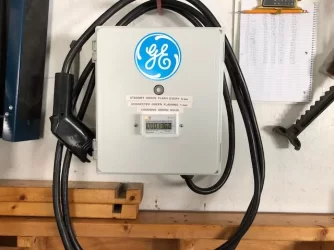

When I had my Prius I was looking for a cheap 240-volt charging station, found one at Costco for $599 (Canadian). Installed it a year ago and it has been operating flawlessly so far, not fancy looking or WI-FI capable but I use the timer setting on the vehicle to charge after 7 pm, to 7 am, when rates are .065 cents (Canadian) a kilowatt hour or use the Honda Link to start charging, or key fob to start charging immediately. The charger is also capable of downgrading to amp service should you not have 240 volts available. My installation was easy as I already had a 240-volt socket in the uninsulated part of the garage, just had to run a 240-volt stove cable through the wall and plug it in the welder socket. The GE Duratation also had a lot of room for me to install a kilowatt meter to it so I can keep track of the cost of charging. Not sure if this interest you or not , I think they might be available at Home Depot too. Here is a picture of mine and a link to utube of one.

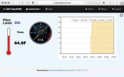

I have a very simple dashboard set up on mine (see below) as I never really had a need for anything more serious. Honestly, the only reason I keep the Wifi module on mine is so I can send it commands when needed (change pilot level, start/stop) via it's built in command page. Even that's pretty rare. Mainly I added the wifi because I wanted to tinker. Mine is DIY so I flashed the HUZZAH wifi board myself and hooked it all up. If I was building another one, and planned to use it portably, I'd probably forgo the LCD screen and the wifi module. They just add too many wires and extra parts that I wouldn't want on a portable unit subject to bumps and shakes.
