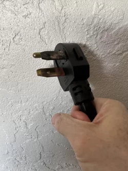

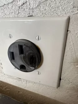

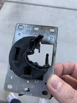

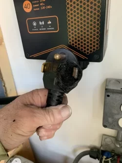

Just wondering if others have had their Enel X Juicebox chargers melt down? Recently had my second issue in 4 years. First unit was replaced, but now I am "out of warranty" as they only cover 3 years from original purchase. $100 off as an "upgrade" is all they are willing to do despite having to rebuild the wall outlet twice. 2 Juiceboxes only lasting approximately 2 years each at 2 different houses installed by 2 different electricians. $100 off is not selling me on a unit that only lasts 2 years.
Any suggestions on why this is happening other than a bad product?
Number 1:
Number 2:

You might consider derating the charge rate.
It was suggested I buy a 40A to cover any future needs which I did. I wasn't aware I could cut back the draw, but I now see on the app I can limit the max amps.
Disappointed nothing was ever said when the first one melted down.
They were so quick to replace it without question, I wondered if it was an issue they were regularly having.
Still makes me wonder, why have a 40A unit if you have to cut it back to keep from melting down?
It looks like you are using a cheap Home Depot outlet. These outlets work fine for ovens, but they are not really built for continuous use that an EV puts on it.
I suggest you spring for a Hubbell industrial grade outlet. Better yet, hardwire the EVSE if you're going to pull 40 amps.
For an adjustable EVSE, you are suppose to hardwire it if your local jurisdiction follows the latest electric code. So that's another good reason for hardwiring the EVSE.

I second this. I have the older 32A version. It melted the outlet that I bought at Lowe’s. I replaced it with a Hubbell outlet and have had no issues yet. As an experiment, I charged my Bolt for 8 hours straight at 32A in the summer, then immediately unplugged from the 14-50 outlet. The prongs were warm to the touch, but not so hot that I couldn’t keep my fingers on them.
I'm surprised they replaced your unit since it is clearly an outlet/wiring problem, not a problem with their EVSE.
Yeah, they were so quick to replace it, no questions asked. I wasn't sure if that was good customer service, or they knew there was a problem with the unit and wanted to replace it. Either way, it never gave me a reason to question the outlet until the second issue. Since the charger was now out of warranty, the best they would do was $100 "upgrade discount" off a new unit. No suggestion that the problem wasn't with their unit so I wasn't encouraged to rush out an buy another product from them that may only last 2 years. I'll repair the plug and replace the receptacle and keep the existing unit.
