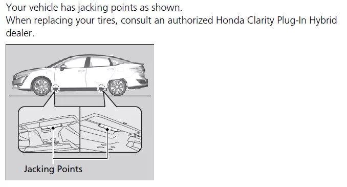

The jacking points are shown on p 534 of the manual. I’m sorry, but my Adobe Acrobat Reader won’t let me copy the picture. They are near outer edge close to rear of front tire well and to the front of the rear tire well. If you don’t have the manual, I can send you a pdf of mine.

@KentuckyKen, thanks for the reply. I did see those but those points, if you look at them under the car, are designed for one of the 'emergency' scissor jacks (like the yellow one below). If you were to put a true floor jack on them it's pretty clear the pinch weld would just bend over unless you got an adapter for it.
I'm looking for a strong, flat spot to put a jack like the green one below. Ideally I'd like to be able to lift the entire rear end or front end of the car from one point so then I can put a pair of jack stands under it.
