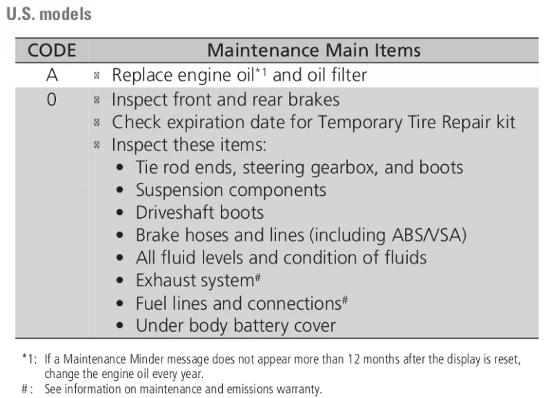

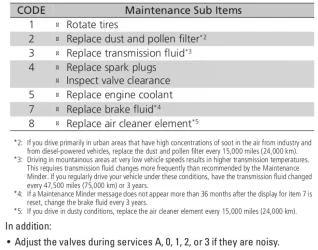

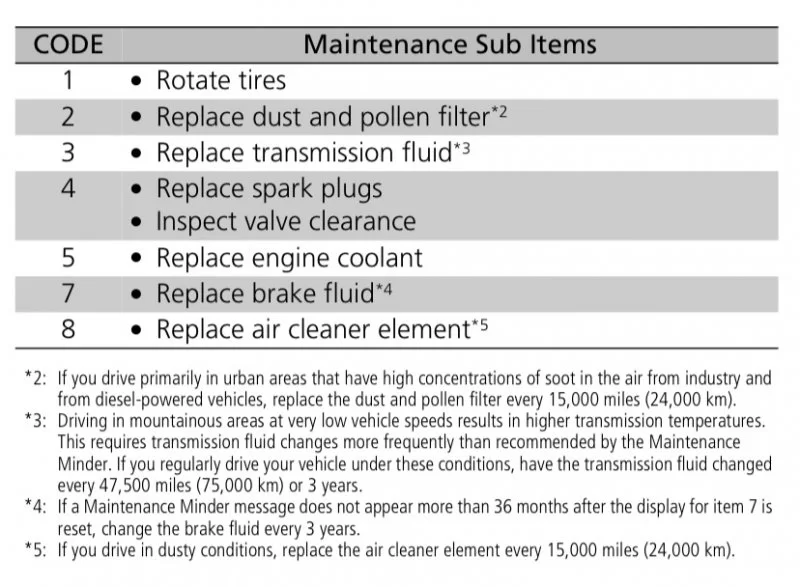

The maintenance minder codes are not entirely based on mileage. Sometimes they are based on time intervals, or how many miles you have gone since last performing a specific operation. At around 26K I got a code of "A017", so perhaps yours was some combination of these.
"A017" is a combination of
A - Oil & Filter Change
0 - Inspection of brakes and various other items
1 - Tire rotation
7 - Brake Fluid Replacement.
These are pretty ordinary and expected except for the "7" which indicates brake fluid replacement.
Here is the complete legend to decode these messages:
1 - Tire rotation

Phew . . . luckily, I took a picture of the Maintenance Minder screen when it first came up (in July 2023 at about 28,900 miles). Just found the photo on my phone. The codes: A 0 1 2 3 7
Hum... I am at 43,000 miles and have not yet received the "3" (Transmission Oil).
Clearly it varies from vehicle to vehicle. Mine is also a 2018 Touring (manufactured Aug 2018, Purchased Nov. 2018).
That is surprising. (But I purchased my 2018 Touring in late December 2017. Maybe there was a change in recommended maintenance during that time.)

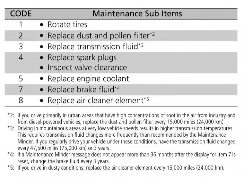

Interesting that it would show 3 at 28,900 miles, which indicates a transmission fluid change is necessary. The manual states that a transmission fluid change may be required at 47,500 miles if the vehicle has been driven under certain conditions.
The wording suggests that the MM would not normally call for 3 at 47,500 miles so it is the responsibility of the owner to determine if the vehicle has been operated under conditions which warrant a transmission service at an interval that is shorter than what would normally trigger the MM.
Or it could be this is a function of calendar time, not just mileage... It will be interesting to see if my "3" appears when I have the same amount of calendar time since purchase. That will happen for me in October of 2024.
Manufacture date: October 2017. (I do live in a mountainous area, though most of my miles are on fairly level roads. Still, in mountainous areas, the manual recommends (p. 477) a change at "47,500 miles (75,000 km) or 3 years." Maybe the Maintenance Minder is giving me a recommendation based on years rather than miles?
My interpretation of the wording in footnote #3, is that MM is not capable of determining the conditions under which the vehicle is operated as pertains to making a recommendation on when the transmission fluid should be changed. It appears to be telling us that the recommended interval is somewhere beyond 47,500 miles or 3 years and we will not be notified of anything other than the recommended interval.
