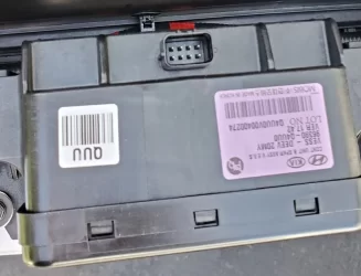

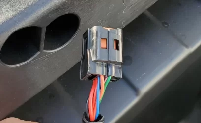

As promised here are the pics. I was right! 8 Pins!
Thanks! Are there indeed 8 wires going into the connector or only 6?
As far as I can tell, that is the newest incarnation, there seems to have been 3 versions, hence the confusion on multiple threads.
Thanks again, Greg
