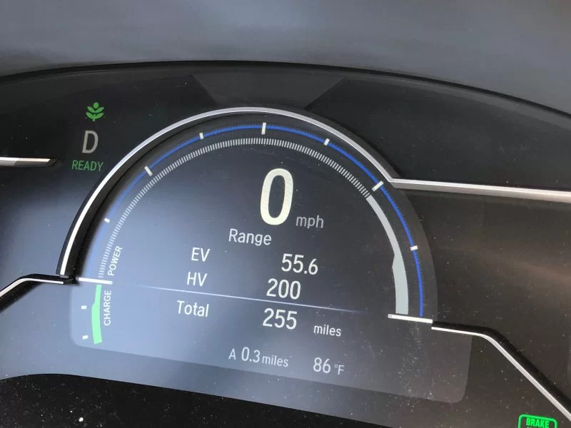

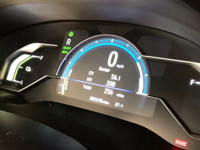

Here are 2 stills and a video. The first still shows the car in EV mode. The video shows the transition from EV to ICE. The second still shows the car is no longer in EV mode.
Bob, I believe you. Your car has something different or wrong with it compared to our normal ones. But it’s not throwing any error codes so the dealer says it’s fine. I would be extremely frustrated at this point as I know you must be.

And you have all that ev range it is showing, too. My Clarity hasn't shown above 44 miles ev range yet but my engine rarely comes on. You are also showing only 200 miles hv. Did you get the hv range update already? If you haven't that would also be weird.
Yes I got the HV update.
