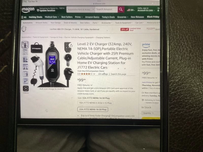

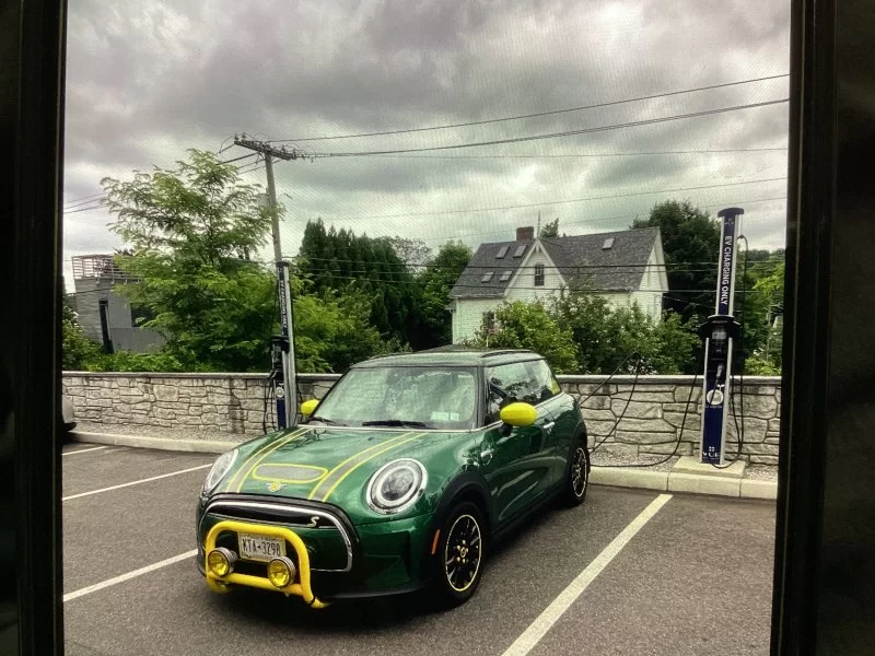

As my Creeper Creek charger 32 amp is 9 years old good for 6 years with I 3 and now for 3 years with SE giving me headaches but unit was checked in factory in CA. As perfect condition I believe is a time to invest in new charger .Any suggestions ? As I need something simple without Wi-Fi 240 V. /32Amp.with NEMA -50 plug to existing outlet.I’m using public charge Charging Point 70 miles away from my house since March 2024 once every week and SE never give me a problem to charge to 100%
As my Creeper Creek charger 32 amp is 9 years old good for 6 years with I 3 and now for 3 years with SE giving me headaches but unit was checked in factory in CA. As perfect condition I believe is a time to invest in new charger .Any suggestions ? As I need something simple without Wi-Fi 240 V. /32Amp.with NEMA -50 plug to existing outlet.I’m using public charge Charging Point 70 miles away from my house since March 2024 once every week and SE never give me a problem to charge to 100% View attachment 23527
A big question if $100 charger will work or i waste money?
For a portable EVSE I went with a J+ Booster 2, good deals to be had on eBay where they sell their refurbished product. More than $100, but quality made and you can get different NEMA plugs if you need them. It comes with NEMA 5-15 (Level 1) and 14-50 (Level 2).
I actually use it to charge my SE every day, since my Lightning is now using my Grizzl-E.
I bought the least expensive MEGEAR 220 V charger off Amazon and it has worked like a charm for the past two years.
