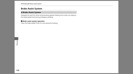

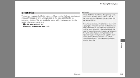

The car also has brake assist which should hit the brakes really hard in the right conditions when you hit the brakes. It’s independent of all the other features. Somehow it detects a panic brake and applys full braking. While verifying the Clarity still has this (my 2013 Civic Hybrid did) I found a note about drying the brakes.
