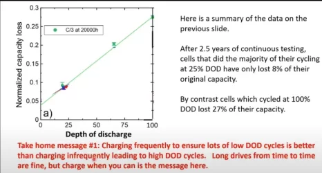

So your question is, given a charging power of 3.8kW, is it better to shallow charge frequently or deep charge infrequently. I suggest asking a Hyundai engineer that question for the Ioniq 5. Internet forums and dealership salespersons or service writers will only get you guesses. Contact Hyundai and see if they will follow up.
Thanks. That was very helpful. My question was answered at this point here. He clearly explains that it's better to charge frequently (after short drives) rather than letting it discharge completely.
