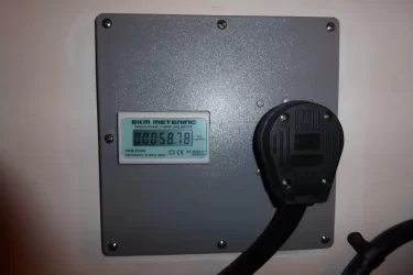

I purchased my Clarity in December and used the 110 volt charger for a few weeks. When I switched to a 240 volt charger, I also installed a KWH meter on the line to the plug.
Since then I have been keeping track of my daily mileage and my KWH used. I have never used all the EV range and the engine has never started.
I use an excel spreadsheet to calculate miles/KWH and MPGe the car has gotten. I live in Utah and our current gas price is about $2.50 per gallon, my current KWH cost is 8.6 cents per KWH. In order to get 110 MPGe, I would have to average 3.784 mile per KWH.
I know its winter and cold and when I run the car the electric heater takes a lot of power, but my lowest miles per KWH has been 2.24 and the highest 3.03. The average is 2.64 which is equal to 76.74 MPGe.
