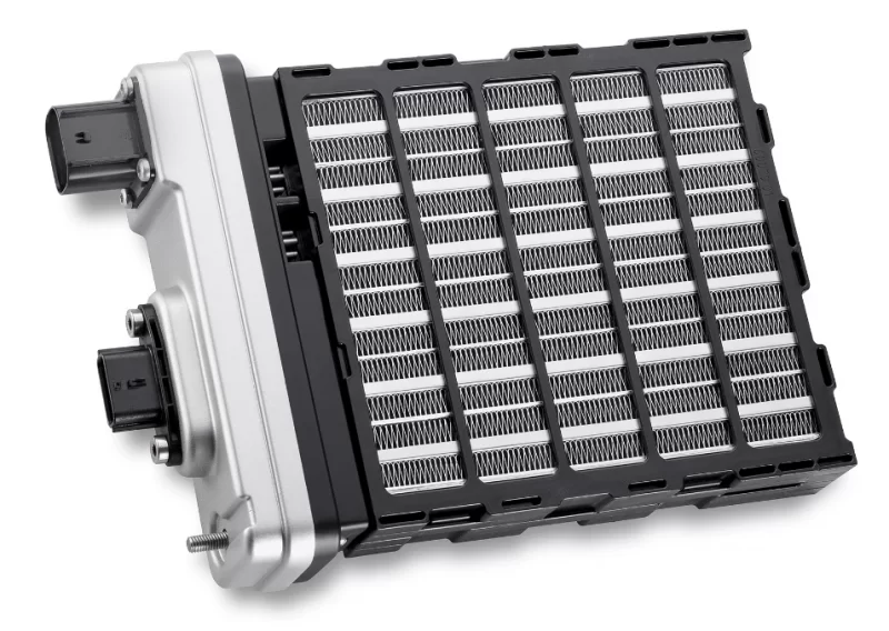

I would expect the "AIR CONDITIONING PTC HEATER" as it's termed by Hyundai to look similar to this, with separate high voltage and control connections.
The Kona's schematic says it has 12V power, CAN and hardware interlock connections on the control connector. The separate HV connection to the battery is fused at 40 amps, although it would only use around 15 amps in use. It's certainly not a simple item.
Looks comparable to this 7 kW unit , with the same HV and LV connections
