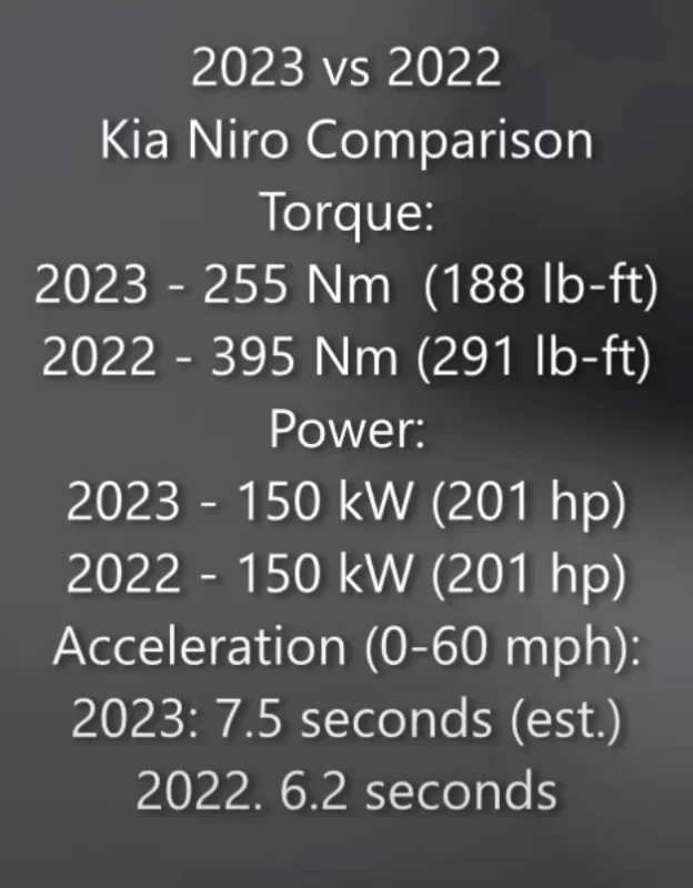

I was watching a YouTube review of the 2023 Niro two nights ago and noticed something odd. Kia have significantly limited the maximum motor torque. Also see this InsideEVs article where it's thought to be a mistaken specification. I expect but have not confirmed that the 2023 Niro is still based on the same Kona/Niro drivetrain.
It's not likely a mistake because the 0-100 km/h time was much longer per the video review.
The video indicates the purpose it to achieve a high range, entirely plausible but I'll just note pessimistically that the gearbox will get a break as well. If it was for range, why not just include that in the "ECO" or "ECO+" settings and let drivers accelerate fast when they want to? It could be that a higher WLPT rating is more important in certain markets than acceleration, and they can't use ECO to achieve that.

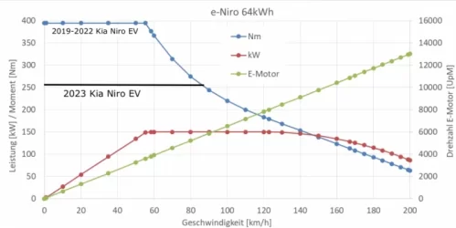

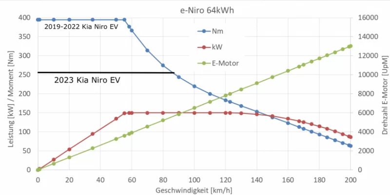

I drew the change on this motor performance graph I just happen to have saved long ago just for comparison and to show why peak power can be quoted to be the same as the old model. The peak power limitation for motors on a torque/speed graph is the curved part and is generally for thermal reasons, getting heat out of the windings. So the curved blue line represents 201 HP when calculated from torque and RPM. RPM is derived from vehicle speed via the gear ratio, 8.206:1
